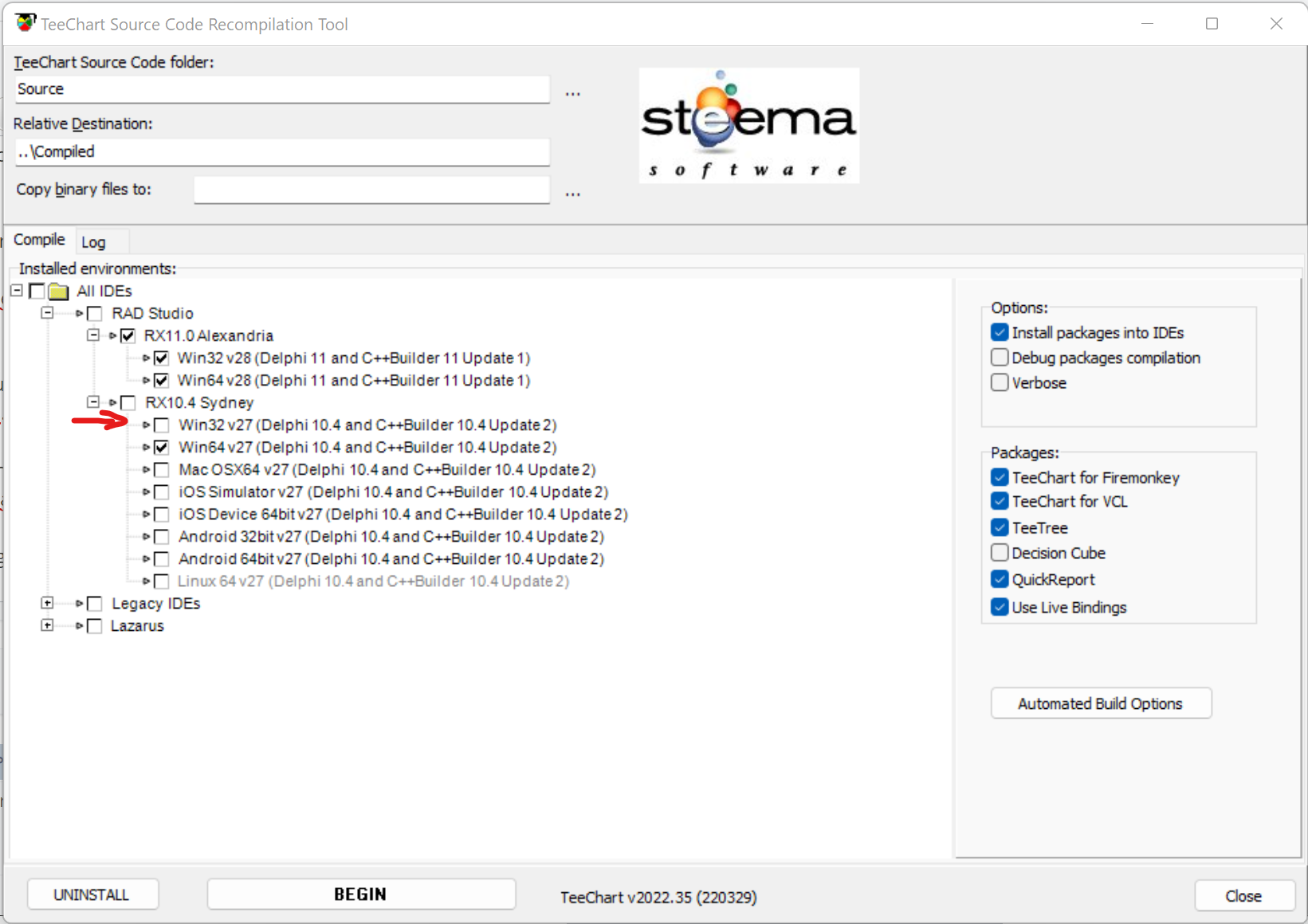

2. Recompile - it detect 4 IDE's. If i check IDE version to recompile, then uncheck it, expand IDE compilers i cannot select first compiler. Example below. I cannot check Win32. I've check whole IDE, uncheck it and second time i can select Win32 for Delphi Sydney.

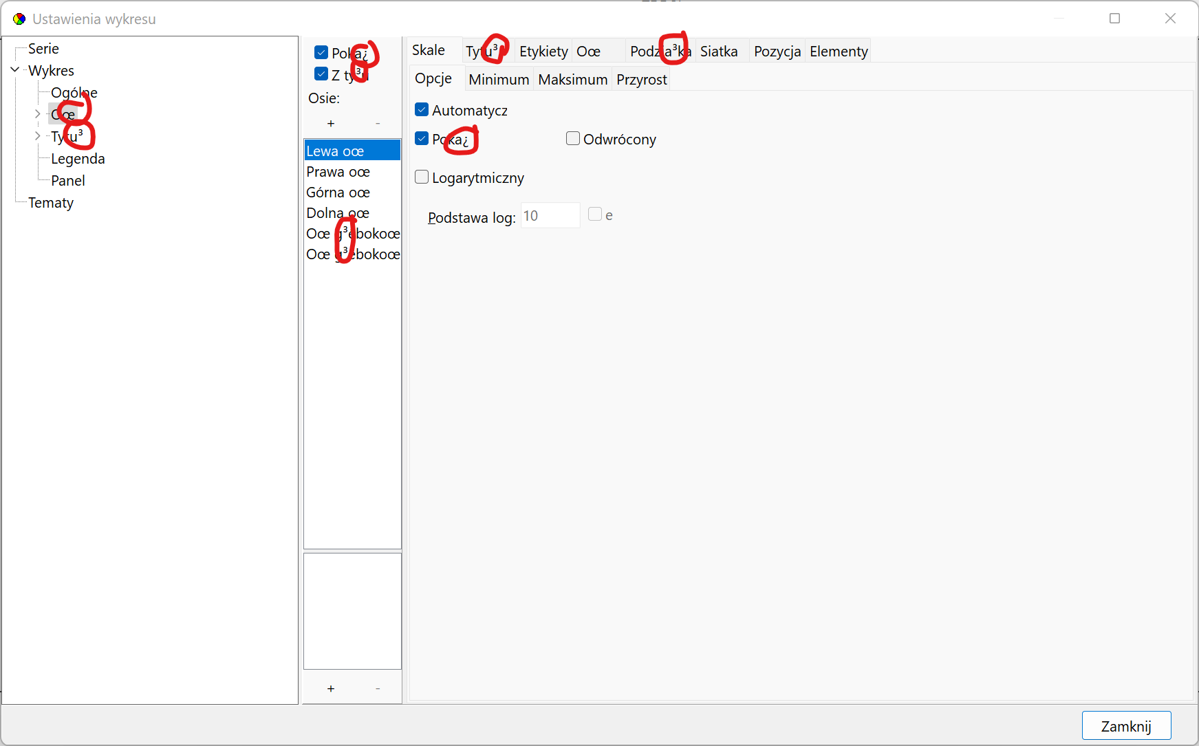

3. After installation but before compilation VCL there are 2 language files - in my example for Polish: TeePolish.pas and VCLTee.TeePolish.pas (maybe also FMX one). First is ANSI encoding, second one UTF-16LE. The UTF-16LE version is broken about translations. It produce this:
bad encoding.png (66.62 KiB) Viewed 14039 times

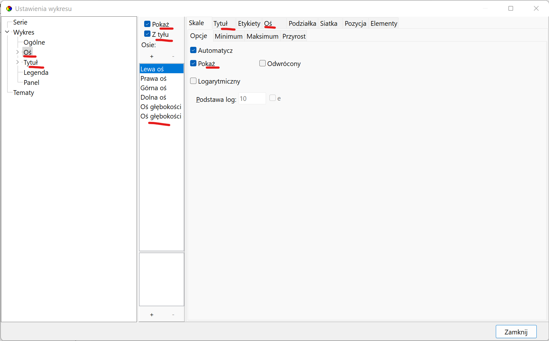

After every update i have to copy content from TeePolish (ANSI) to VCLTee.TeePolish (UTF-16LE) and change conding of file to ANSI or convert external for UTF-16LE. After this i get proper text:

We have been able o reproduce point 2 and are working to resolve it.
This should be fixed in the next release.
Lukasz wrote:
Tue Jun 28, 2022 3:45 pm
I can reproduce the problem but I'm not able to fix it following your instructions.
I've install fresh copy of Delphi 11.2 and tryed to resolve this problem.
After installation Steema VCL i found 7! language files for Polish language but they are the same. These files are:
  • FMXTee.Language.Polish.pas - (..\Source\FMX\)
  • FMXTee.Language.Polish.pas - (..\Source\UnicodeLangs\FMX\)
  • FMXTee_Language_Polish.pas - (..\Source\UnicodeLangs\FMI\) - what is FMI? is there a mistake
  • VCLTee.TeePolish.pas - (..\Source\VCL\)
  • VCLTee.TeePolish.pas - (..\Source\UnicodeLangs\VCL\)
  • TeePolish.pas - (..\Source\)
  • TeePolish.pas - (..\Source\UnicodeLangs\VCL\)
Some of the files are encoded in ANSI and some in UTF-16 LE BOM. File VCLTee.TeePolish.pas located in "..\Source\VCL\" have good translation (encoded in UTF-16 LE BOM). I've opened that file in Notepad++ and copy/paste it's content to the VCLTee.TeePolish.pas located in "..\Source\UnicodeLangs\VCL\" (also encoded in UTF-16 LE BOM but with errors in encoding). After recompile TeeChart i got proper translation in VCL in Delphi. I think the same should be done for FMX.

In 2022.36.220929 translations are good. The problem doesn't exists.
