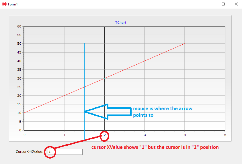

I have a TFastLine Series with big data and i need to show in a box the Cursor->XValue property. The cursor is following the mouse(SnapStyle=ssVertical). The problem is: when the mouse stands in the midddle between 2 X-Values of the Bottom Axis, the cursor moves to next point, while the XValue property of the cursor shows the previous value.
In my application i have big data to show and the chart is zoomed out and i need to be accurate on the value i show.
In the image you can see the error.
I have also made a sample application.
Cursor XValue sometime different from current cursor position

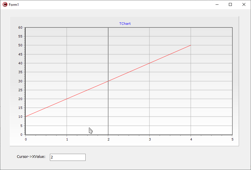

It seems to work fine here with v2022.35:

I need to point that the Cursor error shows when the cursor is EXACTLY in the middle betwwen the two points when slowly moving the mouse from one point to another and stopping in the middle. In the screenshot i've posted above i was moving the mouse slowly from point "1" to point "2" of the bottom axis. When the cursor snap to point "2" i stopped moving the mouse and see the error. In the other cases works well.

The issue here is the OnMouseMove event is triggered before processing the SnapToPoint code so the XValue at that moment still holds the old value.
Instead, you could use the
TCursorTool
's OnSnapChange
event. Ie:

Re: Cursor XValue sometime different from current cursor position
Hello, thank you very much for your support, now all works well.
