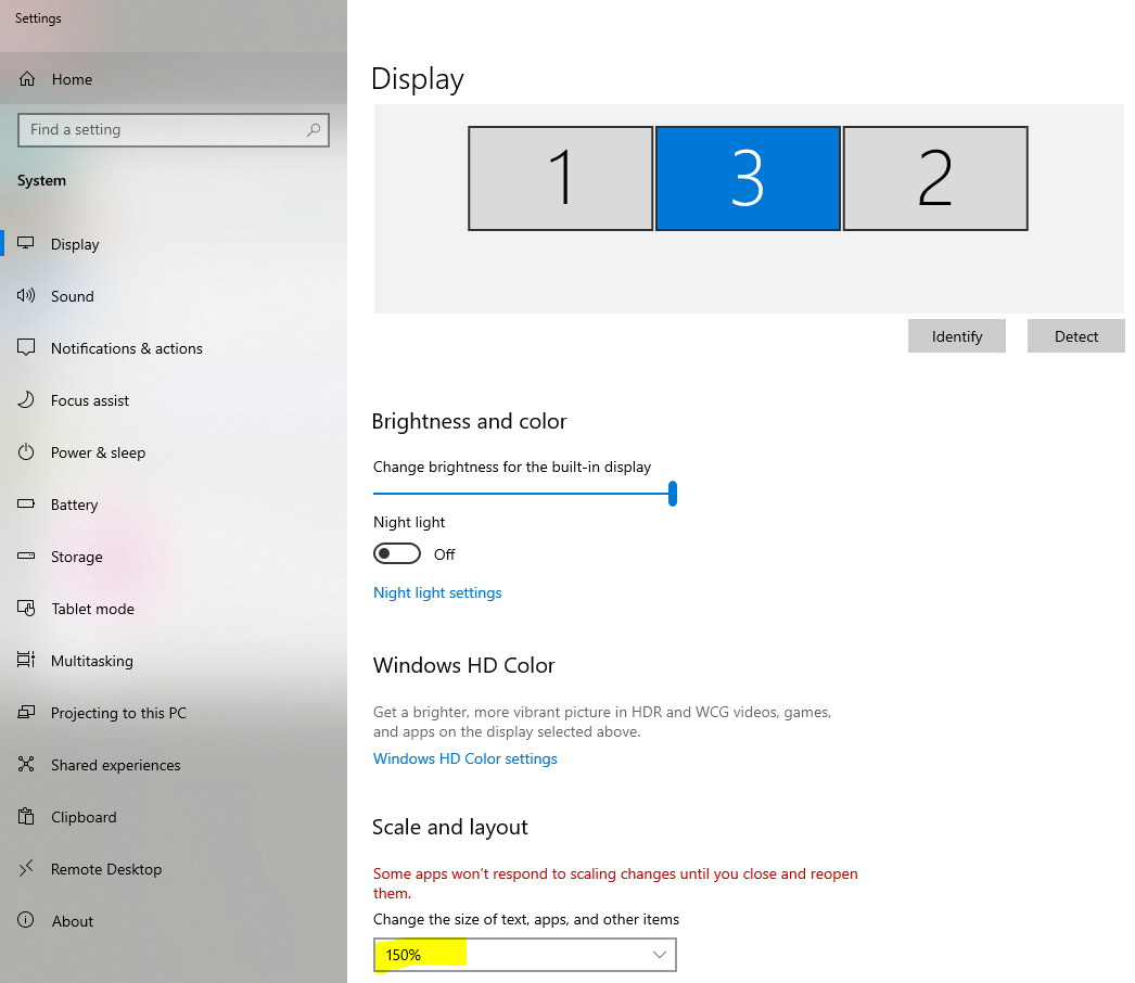

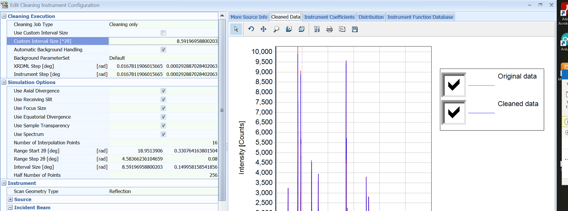

There we noticed that suddenly all the checkboxes to show/hide series
are far too big, as soon as the Display Scaling is bigger than 100%.
The attached screenshot is for a Scaling of 150%:
Partially (for other charts) the Checkboxes get bigger than the whole chart.
Is there a fix available for this bug?

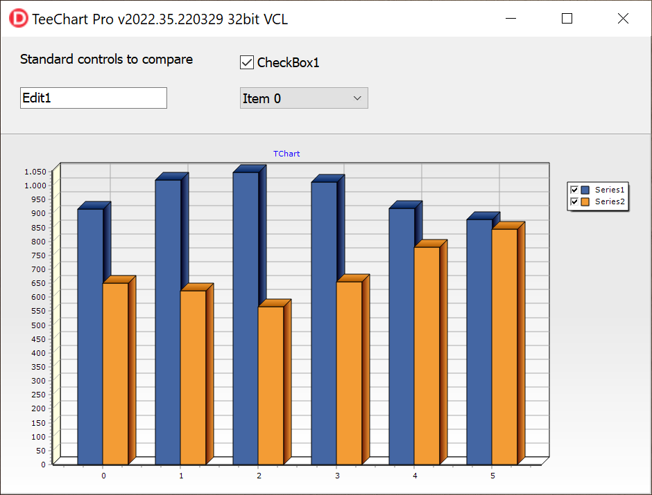

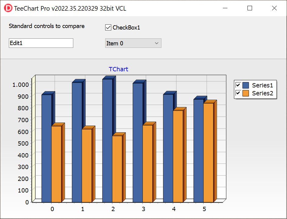

I have two monitors, one at 100% and the other at 175%. I'm running the following test application:
HighDPI_RAD10.4.zip
(24.77 KiB) Downloaded 2148 times
Starting the application at the 100% monitor and dragging it to the 175% monitor everything seems to be correctly resized:
Starting the application at the 175% monitor, fonts and checkboxes are a bit smaller than the standard components:

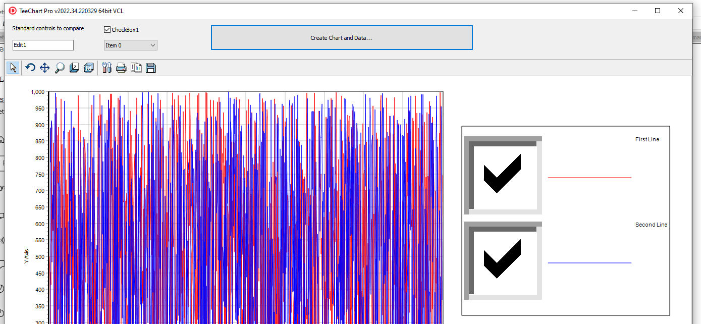

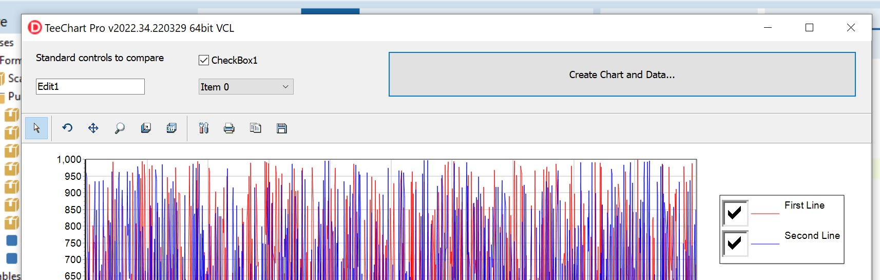

Hello Yeray,
I modified the example, when you press the "Create Chart and data" button (multiple times), just the Checkboxes keep growing. Everything else keeps roughly the correct size.
I also attached the modified project.
