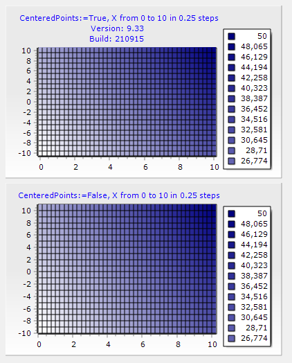

I've just fixed #841 for the next maintenance release which we'll be releasing soon.
This is how your example looks with it:
