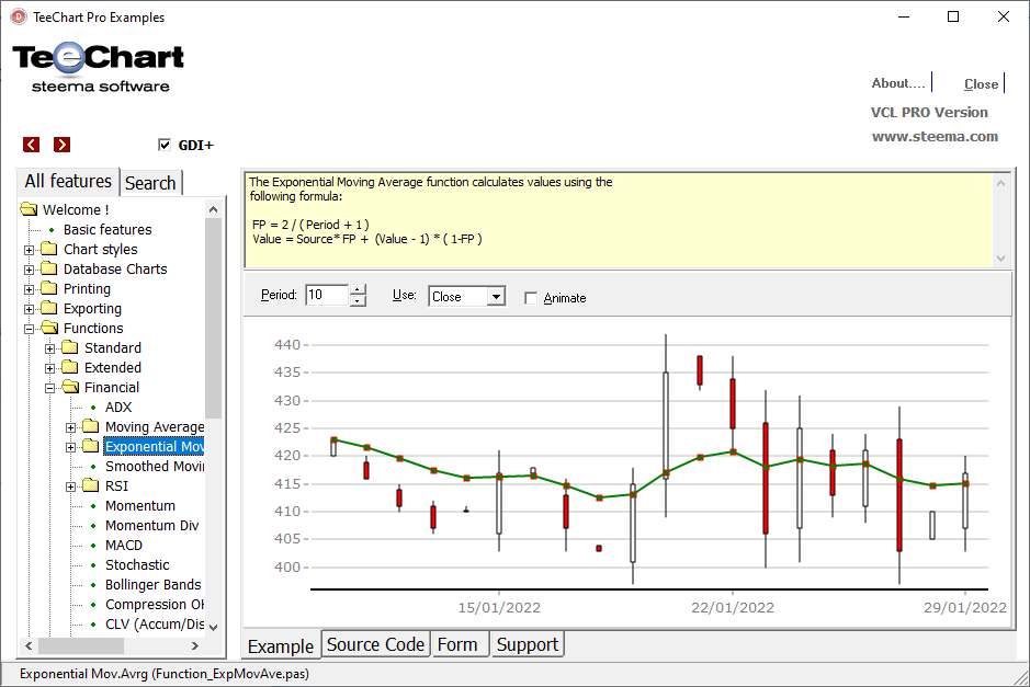

3) Is there a full-fledged example of working with a Stock chart, showing additional elements such as Moving Average, Volume, etc.?
There's a considerable amount of functions available in TeeChart so an example showing all them would be difficult to follow. We prefer showing each function independently at the Features demo shipped with the installation.

The installation already comes with the Delphi demo precompiled. It's named "Tee9New*.exe" and you should be able to find it at the "Examples" folder.

I was able to locate the Tee9New*.exe file in the Examples directory. It ran as expected. However, when I tried to build the corresponding project in the Examples\Features directory, I got an error "Tee9New_Icon.ico" not found. Fortunately, it was available in another folder and I copied it to this directory, and then was able to build the project. I suggest that you make sure the Examples compile and run fine when you ship them along with your product.
