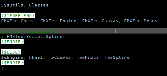

I tried to install the subject version under -Embarcadero® RAD Studio 10.4 Version 27.0.40680.4203 (Update 2). After installation I found that important units were missing (see attached files).
Please note that I did not install the free version of TeeChart, distributed with RAD, because earlier, when I did, the new elements did not appear in the Palette.
Please help.

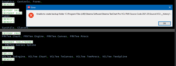

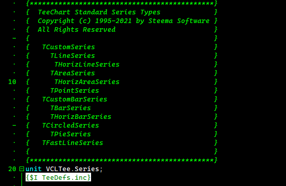

Screenshots with errors, after trying to compile, BEFORE and AFTER adding "VCLTree."
Please advise further actions in order to avoid new obstacles.
Error message after adding "VCL.Tree" to the unit names.
Before adding "VCL.Tree"
TeeChart Installation Problem Screenshot3.png (10.05 KiB) Viewed 9494 times

You don't have to modify the contents of any unit. Instead, you need to add VCLTee at the "Tools/Options, Language, Delphi Options, Library, Unit scope names" menu.
