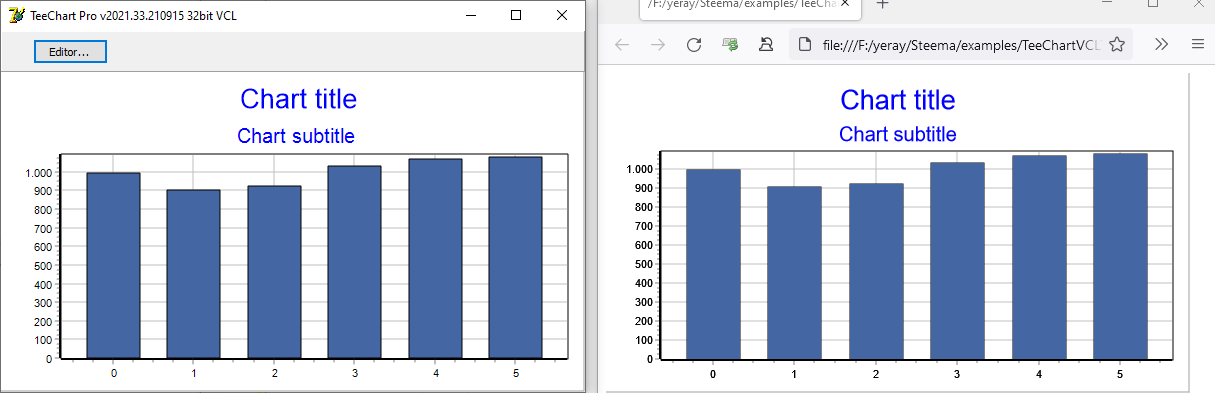

It seams there is no export of subtitles
This seems to work fine for me here. What TeeChart version are you using?
procedure TForm1.SubtitleToHtml;
const fileName='test';
  with Chart1 do
    View3D:=False;
    Legend.Hide;
    Gradient.Visible:=False;
    Color:=clWhite;
    Walls.Back.Color:=clWhite;
    Title.Text.Text:='Chart title';
    Title.Font.Size:=20;
    SubTitle.Text.Text:='Chart subtitle';
    SubTitle.Font.Size:=15;
    with AddSeries(TBarSeries) do
      FillSampleValues;
      Marks.Hide;
  TeeSaveToHTML5File(Chart1, fileName+'.html');
  TeeGoToURL(Handle,fileName+'.html');

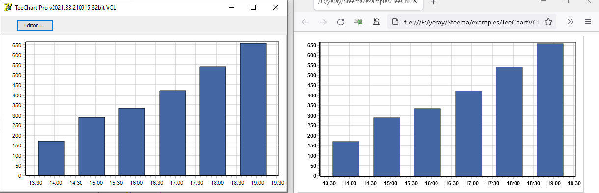

the export of datetime in the JavaScript htm file is in UTC and not in local time like the datetime of the VCL Chart. How can we export datetimes in local time?
I'm not able to reproduce this either. We may be doing something different. Here is what I'm doing:
procedure TForm1.LocalDatetimeToHtml;
var i: Integer;
    tmp: TDateTime;
  with Chart1 do
    View3D:=False;
    Legend.Hide;
    Color:=clWhite;
      XValues.DateTime:=True;
      FillSampleValues;
      Marks.Hide;
      tmp:=Now;
      for i:=0 to Count-1 do
        tmp:=IncHour(tmp,1);
        XValue[i]:=tmp
Could you please arrange a simple example project we can run as-is to reproduce the problems here?
