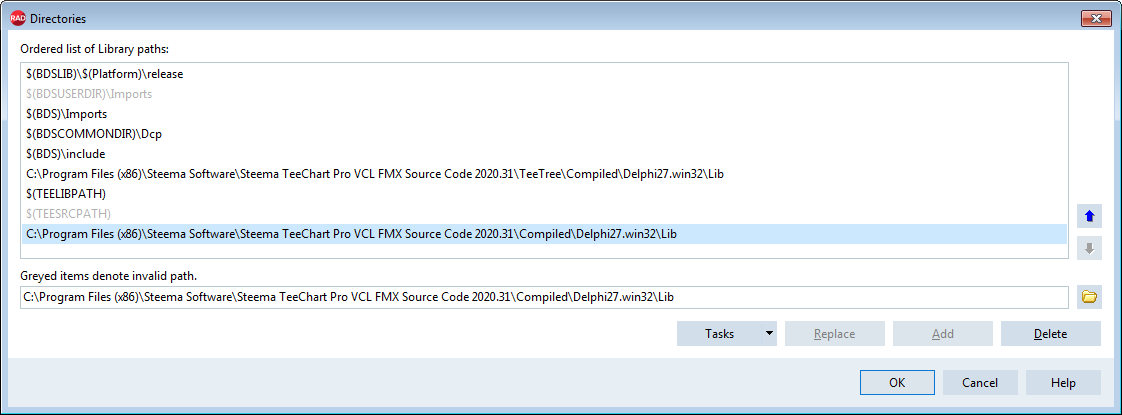

Looking at the Library paths, I see this:
Are you saying I need to add another line, that points to Source\VCL ?
Also, why is the $(TEESRCPATH) flagged as an invalid path by the IDE?

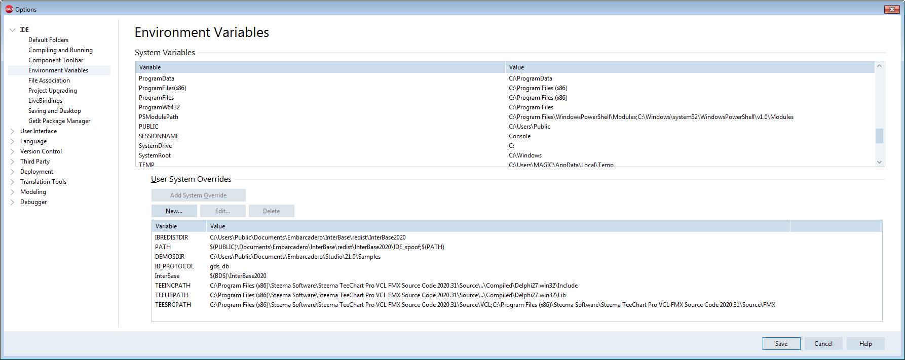

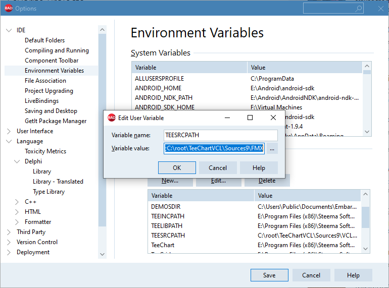

Is the TEESRCPATH defined in the environment variables?
It probably is, and it probably has the value: C:\Program Files (x86)\Steema Software\Steema TeeChart Pro VCL FMX Source Code 2020.31\Source\VCL;C:\Program Files (x86)\Steema Software\Steema TeeChart Pro VCL FMX Source Code 2020.31\Source\FMX
Note there are two paths in the same variable (separated by a ;), which the compiler parses without issues, but the IDE flags it as an invalid path in that editor.
Then, if you want to compile TeeChart as you go, you can leave $(TEESRCPATH) in the Library path. If you just want to use the compiled packages, you can remove $(TEESRCPATH) and leave $(TEELIBPATH) or C:\Program Files (x86)\Steema Software\Steema TeeChart Pro VCL FMX Source Code 2020.31\Compiled\Delphi27.win32\Lib which should be the same.

TEESRCPATH is defined in the environment variables on my system too.
The problem seems to be that when I build my project, Delphi wants to recompile VCLTee.TeeHtml.pas for some reason, even though this file has not been changed.
The compilation then fails because the user doesn't have rights to write VCLTee.TeeHtml.dcu into the Program Files directory (only the Trusted Installer user has the rights to write in Program Files).
Why did all the DCUs get installed into Program Files, where they cannot be rebuilt?
I noticed on your screenshot that your installation appears to be on Drive E:, so you probably won't see this problem.
