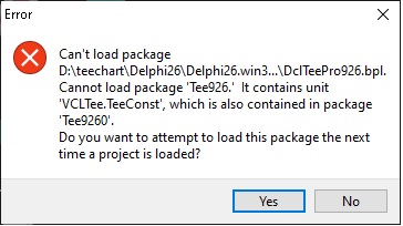

When opening Delphi rio it opens an error to load the VCL bpl. already looked at the paths everything is correct

The error message "Cannot load package *Tee*. It contains unit *, which is also contained in package *Tee*", where any of the *Tee* packages ends with a "0" (*Tee*0), indicates that the TeeChart Standard package that was shipped with the IDE (*Tee*0) is still trying to be loaded, and this creates a conflict with the version you've just installed.
There are two possible causes and solutions for this error:
- If the TeeChart Standard/Lite package shipped with the IDE (*Tee*0) is present and selected in the list of packages in the IDE, please uncheck it. Then you should be able to select the TeeChart Pro/Std commercial package (*Tee*) in the same list.
- There are some 3rd party tools (*) that can be referencing the TeeChart Standard/Lite package shipped with the IDE, and thus causing this conflict. Please try to uncheck temporally any 3rd party tool package you may have installed in the list of packages to try to identify which one is causing the conflict.
