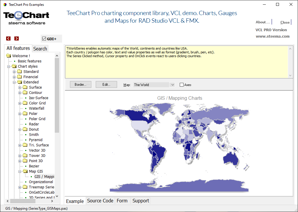

If you want to show values in a map I would try using a TWorldSeries.
I'd suggest you to take a look at the demo shipped with the binary version:
