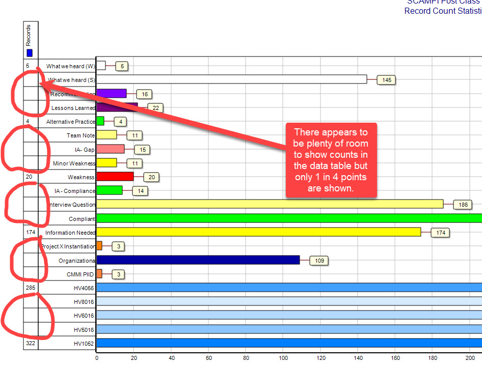

See attached image. The data table only shows the values every fourth bar. There seems to be ample room to draw the value. I have seen that if I reduce the number of points shown, the data table may draw correctly. But even with this sample there is sufficient room to draw the values. Is there some setting I need to adjust?
Missing table values.jpg (188.17 KiB) Viewed 11809 times

I've been able to reproduce it so I've added it to the public tracker (2389).
And I've already fixed it.
Since you own the sources, you can easily apply the fix without having to wait for the next maintenance release.
At line 628 on TeeDataTableTool.pas, substitute this line:
      tmpInc:=Trunc(CalcXYIncrement(SizeLabels));
For these:
      if Horizontal then
         tmpInc:=Trunc(CalcXYIncrement(Abs(LabelsFont.Height)+Round(0.01*LabelsSeparation)));

That's fixed it. Thank you Yeray!
