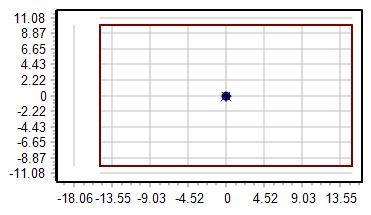

Although the following codes are used, Axis Labels of Increment, Minimum and Maximum values does not show a "rounded" value. What's the story?
      for i := 0 to aChart.Axes.Count - 1 do
          with Axes[i] do
              Automatic := true;
              RoundFirstLabel := true;
              MinimumRound := true;
              MaximumRound := true;

Got the problem. The reason is that the following code is used for TChart.Axes.
LabelsSeparation := 0;
So, TChartAxis skip calculating overlapping labels.
By default, Axis Labels are often too sparse. Is there a better way to mark Axis Labels as closely as possible? Except, LabelsSeparation := 1.
