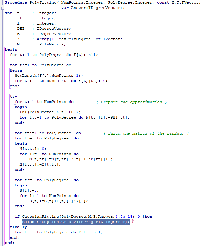

There is an exception string:
TeeMsg_FittingError        :='Cannot process fitting';
and this string is used to raise one exception, and this exception is raised in TeePoly.pas at line 183:
