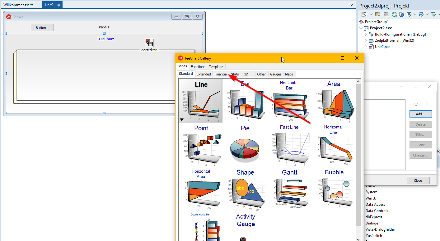

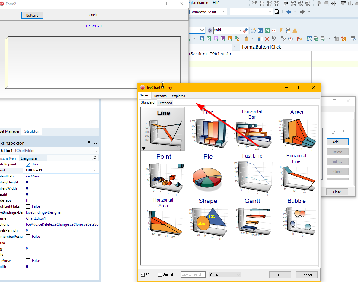

When I try to create a Color-Grid in Runtime the group "3D" is missing. In Design-Time all groups are available. (See Screenshots).
Do I have to activate them?
(Latest Version of TeeChart on Delphi 10.3.3)
Re: Missing Gallery-Groups in RunTime
Post by Yeray » Fri Jul 17, 2020 10:51 am
ello,
Please add the TeeEditPro unit to the uses clause to register all the Pro series and functions.
