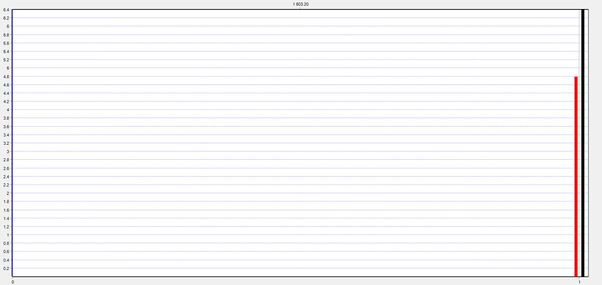

Hello :) ,
First and second of my three problems are shown in the chart joined :
Firstable I need to explain that I fill series as follow :
Series[0].AddXY(Occurs_No, y, FloatToStrF(Value_Of_x), ffNumber, 7, 2));
because I want to display the record number on BottomAxis, and the value of this record right in front, on TopAxis.
My first problem is that, Doing so, I'm not able to align the two values correctly on the grid, "face to face".

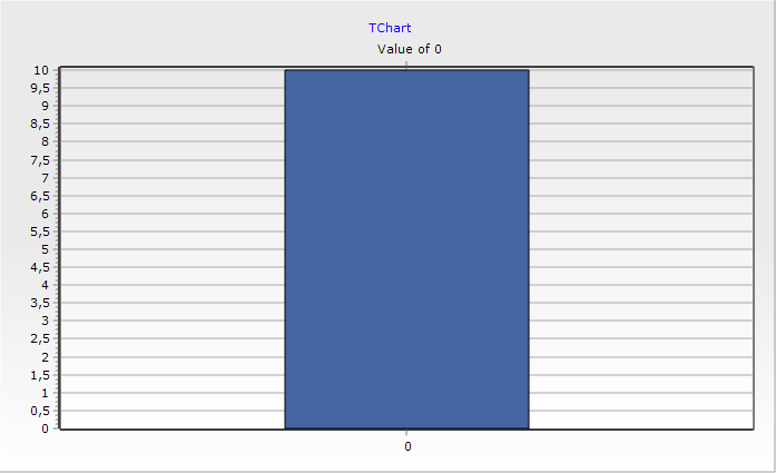

And my second problem is that, as you can see on the chart, when my data source returns only one record, the BottomAxis value is not shown in the middle of the axis, as my dreams would like.
I think the two problems are linked...
Could some one tell me how to resolve my problems, please :? ?

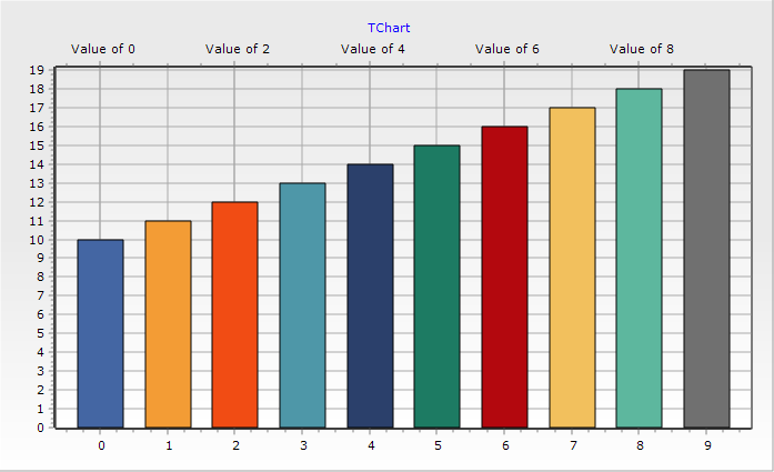

We'd need a simple example project we can run as-is to reproduce the problem here because I see no problems trying to achieve what I'm understanding you described:
uses Series;
procedure TForm1.PopulateSeries(ACount: Integer);
var i: Integer;
  Chart1[0].Clear;
  for i:=0 to ACount-1 do
    Chart1[0].AddXY(i,(i+1*10),'Value of ' + IntToStr(i));
procedure TForm1.BMultipleValuesClick(Sender: TObject);
  PopulateSeries(10);
procedure TForm1.BSingleValueClick(Sender: TObject);
  PopulateSeries(1);
  Chart1.View3D:=False;
  Chart1.Legend.Hide;
  Chart1.Axes.Top.LabelStyle:=talText;
  Chart1.Axes.Bottom.LabelStyle:=talValue;
  with TBarSeries(Chart1.AddSeries(TBarSeries)) do
    ColorEachPoint:=True;
    HorizAxis:=aBothHorizAxis;

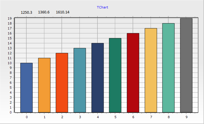

It's close to that. But the value I want to display on top axis is not the value of "i", but the value contained in the record number "i" :
DataSource :
1: 1250,30
2: 1360,60
3: 1610,14
Writing this, I realize that top axis must be out of sync from bottom axis. Sorry :?
I'd just like to display
1, 2, 3
on bottom axis and in front of each of these values, on the top axis
1250,30
1360,60
1610,14
Thanks for your help.

...and when I define TopAxis.Automatic at False,
it don't show anything anymore :( .

I'm using an array to store the values to be displayed on the top but using a datasource should also work:
var topValues: array of double = [1250.30, 1360.60, 1610.14];
var i: Integer;
  FormatSettings.DecimalSeparator:=',';
  FormatSettings.ThousandSeparator:='.';
  Chart1[0].Clear;
    with Chart1[0] do
    if i<Length(topValues) then
       AddXY(i,(i+1*10),FormatFloat('#,##0.##',topValues[i]))
       AddXY(i,(i+1*10));

I do a clear chart, before creating the series dynamically.
Maybe I not define something correctly. :roll:
