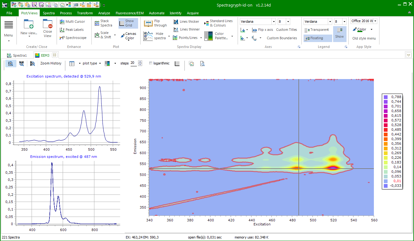

I use a TContourseries to plot 2D spectral data. While hovering with the mouse, it always paints a red higlighted trace for all contours that have the same z value as the current mouse position. With contours of complex shape, this slows down the program extremely. I also use a cursor tool, to let the user extract cross sections, and this gets unusable in this mode. I then have to switch to TColorGridSeries, which doesn't have the problem, obviously.
I really don't need that contours highlighted, but couldn't find a property or method to turn this behaviour off. Any advise?

- screenshot_highlighted_contourlines.png (88.19 KiB) Viewed 18682 times

O.M.G. This is awesome, the speed increase is tremendous. It now reacts nearly realtime even for large data sets (like 1700 x 6500 data points).
Thank you very much!

Hmm, something like Series1.DrawAllPoints:=false; Series1.DrawAllPointsStyle:=daMinMax; but for 2D display would be so helpful. Obviously, the same principle would apply here, as only as many data points can be visualized as screen pixels are available...
As described, with Hover.Visible:=false, things like moving the CursorTool or moving the Zoom rectangle with the mouse now work instantaneously. Also, using the CursorTool.Onchange event for creating the cross sections works lightning fast for any size of the 2D plot. This is true for both ContourSeries and ColorGridSeries. I found that assigning the data on creation is also reasonably fast, and setting irregular:=false makes no difference for me, as the data has regular spacing (while not using Integer values for XValues and ZValues). I don'T use grid lines, and only solid lines otherwise.
However, every action that involves (re-)painting of the plot becomes tediously slow for my larger arrays. This includes, zooming in or out, panning, using TAxisScrollTool, TAxisScrollbar and the like. A simple refresh for a TColorGridseries takes 19 seconds for the big 1700 x 6500... Quite a lot for a 500x1200 pixel image...
While I don't understand enough, this thread seems very interesting to me: viewtopic.php?f=4&t=3316 It is from 2006 and from the .NET section... Could you confirm, that these improvements in speed and efficiency were als implemented for the VCL version?
I think I have to look into reducing the number of data points towards the chart size in pixels before adding the array, and the re-add an updated section every time when a pan or zoom happens. Quite sure this will be faster than waiting for chart refreshing with the whole data set inside. It is just that I might loose something in the display, which si why I was asking for a daMinMax option...
