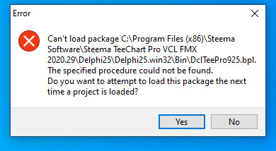

I get the following errors when trying to add the package on the project options.
Can't load package .... DclTeePro925.bpl (Image attached)
The specified procedure can not be found.
The project I have was working fine with 2018 TeeChart Installer.
I am using Embarcdero C++ 10.2
I have tried creating a new project but I get the same error. I get the linker error
Unresolved external 'Vcltee::Series::TPointSeries' so I was wondering if this is related to me not having the 2020 packages selected in the project options.
I am new to using packages and embarcadero so any help would be appreciated.

I found out what the problem was. I was using the Steema installer designed for a community edition when I was using Pro. Using the installer designed for starter enabled the components to be included and no linker issues.
