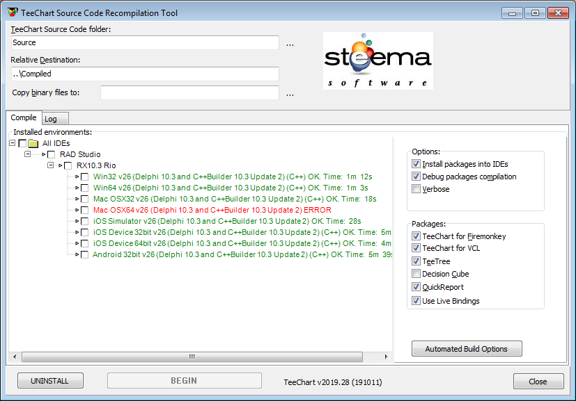

I encountered an error when installing the latest TeeChart VCL, into a clean copy of Windows 7 and a fresh install of RAD Studio 10.3.2 Rio.
The compilation failed for Mac OSX64, as you can see here:
Steema Install Error.png (56.39 KiB) Viewed 14568 times
The log file says:
Mac OSX64 v26 (Delphi 10.3 and C++Builder 10.3 Update 2)
FMXTee926
Cannot recompile Delphi package: FMXTee926.dpk
Embarcadero Delphi Next Generation for Mac OS X 64 bit compiler version 33.0
Copyright (c) 1983,2018 Embarcadero Technologies, Inc.
Linker command line: "C:\Program Files (x86)\Embarcadero\Studio\20.0\bin\ld.exe" -arch x86_64 -o "C:\Program Files (x86)\Steema Software\Steema TeeChart Pro VCL FMX Source Code 2019.28\Source\..\Compiled\Delphi26.osx64\System\bplFMXTee926.dylib" -map "C:\Program Files (x86)\Steema Software\Steema TeeChart Pro VCL FMX Source Code 2019.28\Source\..\Compiled\Delphi26.osx64\System\bplFMXTee926.dylib.map" -e __ZN9Fmxtee92614initializationEv -dead_strip -dead_strip_dylibs -mark_dead_strippable_dylib -exported_symbols_list "C:\Program Files (x86)\Steema Software\Steema TeeChart Pro VCL FMX Source Code 2019.28\Source\..\Compiled\Delphi26.osx64\System\FMXTee926.exp" -dylib -export_dynamic -macosx_version_min 10.8 -F \System\Library\Frameworks -F \System\Library\PrivateFrameworks -L "C:\Program Files (x86)\Embarcadero\Studio\20.0\Lib\osx64\Debug" -L "C:\Program Files (x86)\Embarcadero\Studio\20.0\Redist\osx64" -L "C:\Program Files (x86)\Steema Software\Steema TeeChart Pro VCL FMX Source Code 2019.28\Source\FMX" -rpath $ORIGIN -install_name @rpath/bplFMXTee926.dylib -filelist "C:\Program Files (x86)\Steema Software\Steema TeeChart Pro VCL FMX Source Code 2019.28\Source\..\Compiled\Delphi26.osx64\System\FMXTee926.lnk"
Error: E2597 ld: warning: directory not found for option '-L/usr/lib'
 ld: warning: directory not found for option '-F\System\Library\Frameworks'
 ld: warning: directory not found for option '-F\System\Library\PrivateFrameworks'
 ld: warning: directory not found for option '-F/System/Library/Frameworks/'
 ld: file not found: /usr/lib/libiconv.dylib
Fatal: F2588 Linker error code: 1 ($00000001)
EXCEPTION:
Compilation aborted.
Any thoughts on what could be happening here?

Could you please configure a MacOS64 platform SDK in your IDE and give it another try?
