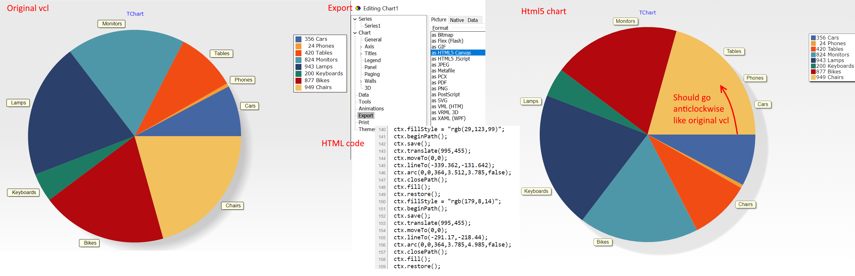

We have an issue with Pie Chart. We show it on a browser using the HTML5 Canvas export function. In HTML5 the Pie slices are drawn clockwise, the original vcl one was anticlockwise. We transfer the HTML5 click to the original vcl Pie resulting obviously a wrong clicked slice.
If you see my screenshot of the two pie images it is like the HTML5 one is vertically flipped, however the marks stayed at their original place which is obviously wrong.
Can you fix the export, please? Do you have any workaround suggestion until then?

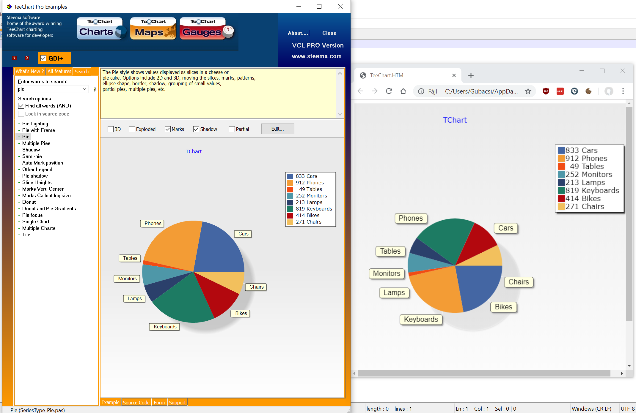

I try to be more exact:
Export as HTML5 Canvas details.png (214.21 KiB) Viewed 10627 times

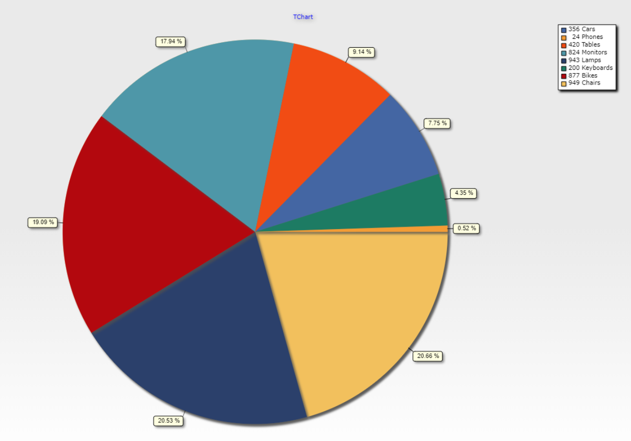

The javascript export returns a result which is even more different than the original vcl chart. It looks like this for the same vcl chart.
Export as HTML5 JScript.png (115.37 KiB) Viewed 10627 times
It looks this slices are ordered by value. It had the link you were looking for in the generated file
