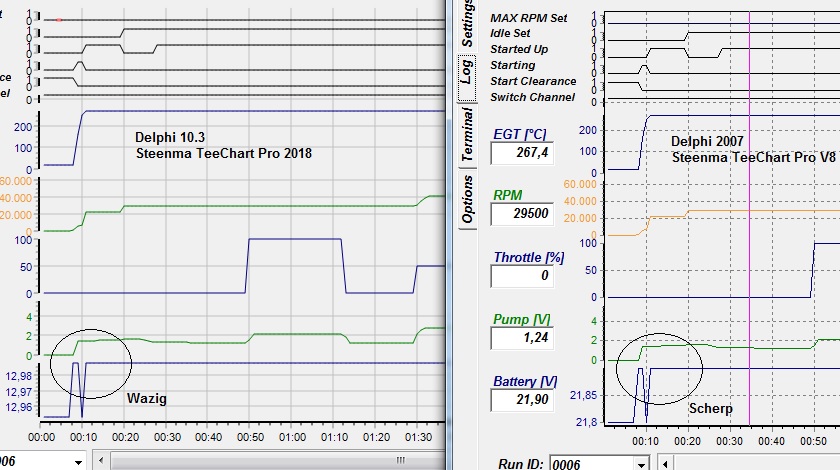

Just compile application with Delphi 10.3 and Teechart Pro 2018/
Result is different line thichness.
TMC grafiek.jpg (136.3 KiB) Viewed 7592 times
Left new version blurry and right the old version which is correct.
Please help!

Post by Yeray » Fri Jun 14, 2019 6:47 am
We moved from GDI to GDIPlus as default canvas from TeeChart v2013.09.
Take a look at the options you have to change from GDIPlus to GDI:
https://www.steema.com/support/viewtopi ... 763#p71763
https://www.steema.com/support/viewtopi ... 483#p66483
