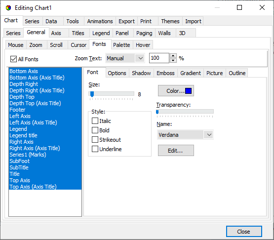

I see soo many places that fonts are used in a chart, and we are wanting to switch from Arial to Calibri. Is there a quick way to change the fonts on a chart? (It would be nice if there was just a place that allowed me to edit just the fonts for the various objects).

You can navigate to the "Chart\General\Fonts" tab in the editor, select "All Fonts" and change the settings:

That is sweet! Way to make my Friday!
