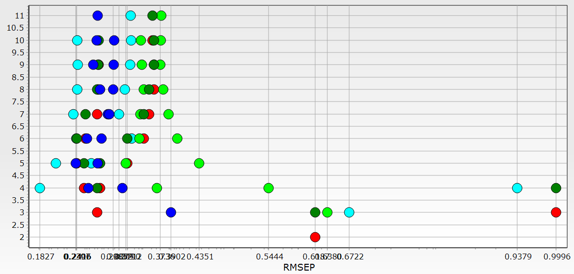

I have created a Chart with a couple of "TBubbleSeries"
Each BubbleSeries has its own color.
In call "AddBubble" I add individual X and Y values.
That produces a Chart with multiple/overlaid bottom axis:
How can I prevent that, how can I make sure all the bubble
seris are using the same bottom axis ?

Oh, I just see, this confusion on the X (bottom) axis happens when I supply Labels in call TBubbleSeries.AddBubble().
Why are the labels displayed on the X axis ?

Attached an example project that shows that the Labels are displayed on the X axis instead of the X values given for the Bubbles

The extra line in the code snippet below will force the xaxis labels to render the values of the points and not their labels. By default, the LabelStyle property is set to talAuto which will render the xaxis labels as the string labels of the points.

Hello Christopher,
thank you, I just found out myself too by changing/trying almost any property in the paged dialog.
Isn't that a quite strange Default?
I would expect "TAxisLabelStyle.talValue" to be the Default.

That's will probably depend on the case. Some people argues that, once you have labels in a series, they'd expect them to be shown in the axis.
