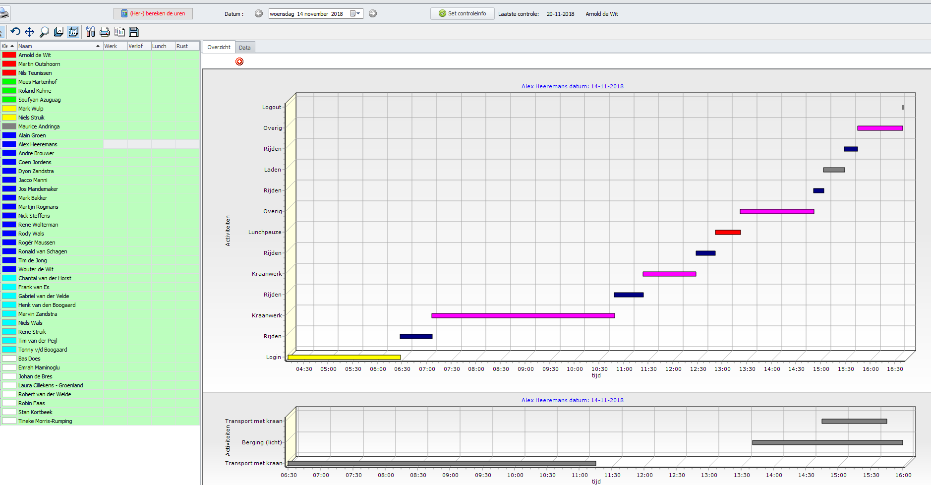

The two Gantt Charts are related. The Timelines are different, however. How can I achieve that they are equal?
Edit the lower Gantt so that it is equal to the upper one?
Henk

You can change the bottom axis scale for the lower chart. Ie:
  lowerChart.Axes.Bottom.SetMinMax(upperChart.Axes.Bottom.Minimum, upperChart.Axes.Bottom.Maximum);

Something strange happens: setting the bottom axis happens with a delay of a click. See Video
The Bottomaxis automatic is set to false.
The code is:

Problem solved by putting a Chart1.Repaint
