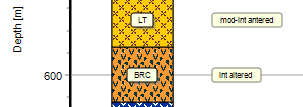

I use stacked bar charts to represent a geological column. Besides each section (strata) I place a comment using the code below:

This places the comments correctly when first displaying the graph and when called after the OnZoom, OnUndoZoom and OnScroll events. However, calling PlaceComments in the OnMouseWheel event misplaces the marks up or down as shown in the following figures.

Correct position of comments
I would be grateful if you can suggest how I might fix this.

Regarding the problem with the marks, note the OnMouseWheel event is fired before applying the axis scroll. That's why your PlaceComments method doesn't calculate the positions properly. You can set a flag at OnMouseWheel and call PlaceComments at OnAfterDraw event when that flag is set. Here a simple example:

Thank you for your assistance here. I have implemented your suggestions and it works fine now. Obvious really, once one knows how to do it, but I find the TeeChart events a bit daunting at times.
