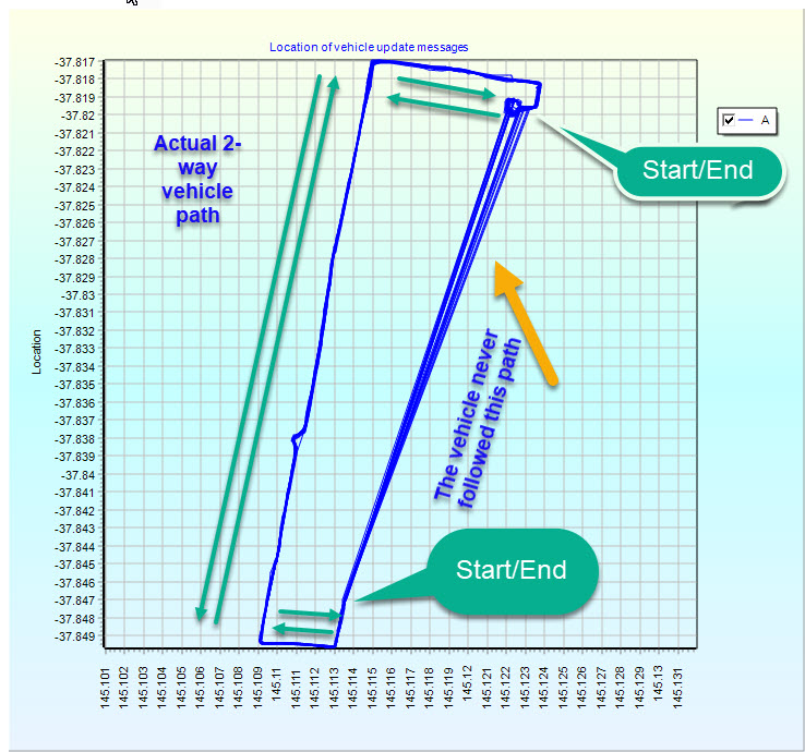

Re: Plotting Lat/Long data as LineSeries gives incorrect display
Thanks Yeeray, that's a minor improvement, but the start/end points lines are still being incorrectly connected. The graphic below shows the real vehicle path (green arrows). The graph has shown that, and also taken a shortcut, joining the start and end of the route with straight lines.Yeray wrote:Hello,
This probably happens because the values are x-sorted by default. You can disable this with:Code: Select all
Series1.XValues.Order:=loNone;
I tried also Series.YValues.Order:=loNone; but that did not make a difference
- 2018-06-16_23-31-20.jpg (174.47 KiB) Viewed 25651 times

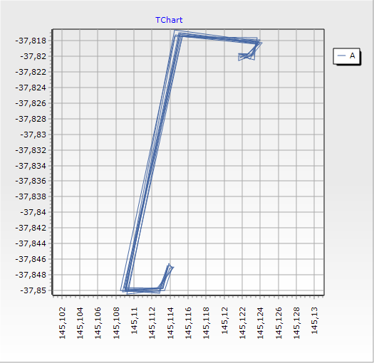

I've done a simple example trying to reproduce the problem here, but it seems to work fine for me.
Could you please modify the above or arrange a simple example project we can run as-is to reproduce the problem here?

procedure GoAndBack;
var i: Integer;
for i:=0 to Length(xPoints)-1 do
Chart1[0].AddXY(xPoints[i]+random*0.001-0.0005, yPoints[i]+random*0.001-0.0005);
for i:=Length(xPoints)-1 downto 0 do
var i: Integer;
Chart1.View3D:=False;
Chart1.Legend.LegendStyle:=lsSeries;
Chart1.Axes.Bottom.SetMinMax(145.101, 145.131);
Chart1.Axes.Bottom.LabelsAngle:=90;
with Chart1.AddSeries(TFastLineSeries) as TFastLineSeries do
Title:='A';
for i:=0 to 4 do
GoAndBack;

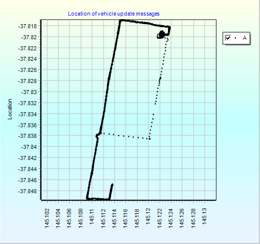

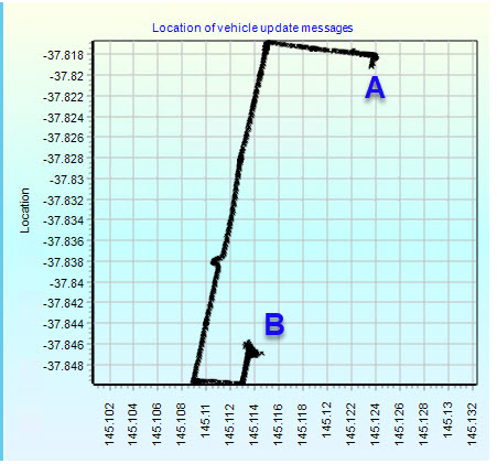

I may have located the cause, but I don't yet know how to resolve.
I have found that the vehicle records when it goes 'online' and travels from A(north) to B(south). It then goes 'offline' while it tracks back to point A again, goes online, and then starts recording the track from A to B again. Sometimes it is two-way data and other times it is one-way only.
The unintended line was drawn when point A was the next available point after the previous last point B
I thought I might resolve this by only plotting if the distance between the two points is less than a 'threshold' value.
I can calculate the great circle distance between the two adjacent points, and if it is greater than a threshold, I want to avoid drawing that 'track' on the graph.
I tried just bypassing the call if the distance was greater than 300 metres:
However, even though the distance was much greater than 300 meters, the line still was drawn (presumably) on the following point from the array.
I also tried using Series.AddNull, unsuccessfully.
How can avoid drawing the line if the distance from B to A is greater than a specific value?
Many thanks for your kind assistance

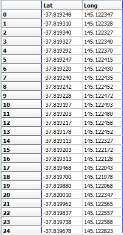

Hi Team
I have created a program that reproduces my issue.
It needs the csv data file to be copied to the same location as the exe.

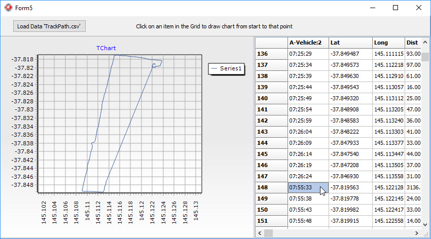

Click on a point on the grid to draw the chart to that point. The problem occurs at row 148.
If I can determine how to avoid plotting those points where the distance is excessive, this would allow me to solve my problem.
I have uploaded a sample program that reproduces my issue (ChartTrackingIssueWithSrc.zip).
Many thanks.

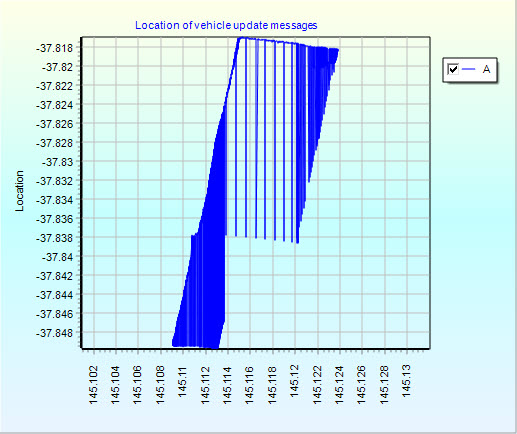

The null points should do the trick for you. If you are using a TFastLineSeries, try changing it to a TLineSeries to see if it makes any difference.
If you still find problems with it, please try to arrange a simple example we can run as-is to reproduce the problem here.
- Newbie
- Posts: 17
- Joined: Thu Jan 04, 2018 12:00 am
Thank you
Both changing from FastLineSeries to LineSeries, and adding the null worked.
Your assistance is greatly appreciated
Dist := GetDistanceBetweenTwoLocations(ThisPt, LastPt, False);
if (Dist < 500) then
Series1.AddXY(ThisPt.X, ThisPt.Y)
Series1.AddNull;
