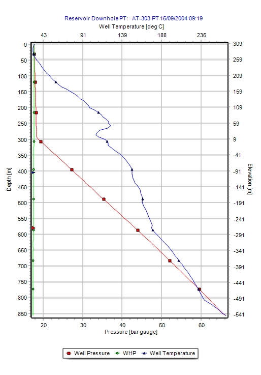

I wish to plot temperature data from a deviated well against measured depth, with vertical depth on the opposite axis. I have tried to attach a file of typical data but without success. Suffice to say that the measured depth / vertical depth relationship is not linear.
If the axis range and increment have been specified, it will be relatively easy to calculate the vertical depth at each measured depth increment (or vice versa), by an interpolation process (linear interpolation is usually fine) and write the axis label a the appropriate place. However, if the graph is on autorange and autoincrement, how do I find the positions at which there is a label on the primary independent axis?
If this or a similar question has been asked previously, a code example would be greatly appreciated.

I want to create a graph of Depth (on left axis) vs Temperature (top axis) and Pressure and WHP (bottom axis), with the corresponding Elevation displayed on the right axis.
The Elevation axis has to be a dummy axis without plotted against it - as the well is deviated, the relationship between Depth and Elevation is not linear. I have plotted Pressure against Depth and Elevation on the attached image, and you can see the two (blue) curves do not match.
So what I want to do is draw a Custom Elevation axis, showing major ticks and labels. There seem to be two options:
1. Draw evenly-spaced major ticks, corresponding to the major ticks on the Depth axis, and write the calculated elevation at each tick. The elevation calculations are no problem, but if the Depth axis is set to Automatic Scale, how do I find the Depth values at the major ticks?
2. Draw ticks at even elevation increments (say every 100 m). In this case, the tick marks will not be evenly spaced along the axis. I can calculate where each tick will be in relation to the minimum and maximum values on the Elevation axis, but is it easy to specify ticks at user-defined positions?

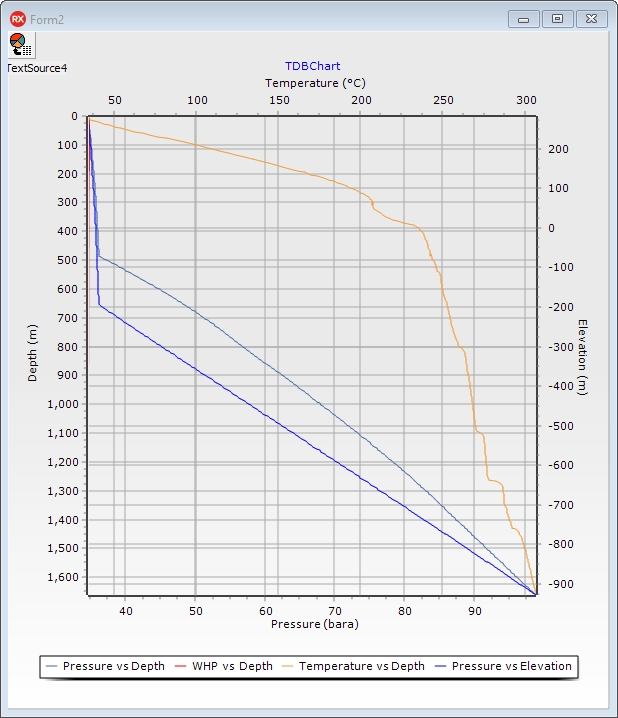

I am pleased to report that I have been able to create a Depth axis on the left and an Elevation axis on the right, by duplicating the series to plot on both axes. I have used CalcIncrement to get the left and right axis labels to line up, and the OnBeforeDrawAxes event to ensure the right axis draws correctly after scroll and zoom. I then hidden the duplicate series by setting them to 100% transparency. As the program counts series to assign symbols and line colours correctly to multiple data sets, I will have to skip the count for the duplicate series.
The example project is attached. I have two questions:
1. When I zoom in a number of times, the program freezes. Can you suggest why this might happen.
2. Is there any way to label the duplicate series with a Tag or similar, so it will be easy to not count these series when allocating symbols and colours to the visible series?
Best regards

I think you could avoid using that hidden series by assigning both vertical axes to the first series and using OnGetAxisLabel event to format the right axis labels:
procedure TfrmPTChart.FormShow(Sender: TObject);
  //DrawRightAxis;
  Series4.Visible:=False;
  Series1.VertAxis:=aBothVertAxis;
procedure TfrmPTChart.DBChart1BeforeDrawAxes(Sender: TObject);
  //DrawRightAxis;
procedure TfrmPTChart.DBChart1GetAxisLabel(Sender: TChartAxis;
  Series: TChartSeries; ValueIndex: Integer; var LabelText: string);
var tmp: Double;
  if Sender = DBChart1.Axes.Right then
    tmp:=StrToFloatDef(ReplaceStr(LabelText, ThousandSeparator, ''), 0);
    tmp:=Round(Elev(tmp));
    LabelText:=FormatFloat(Sender.AxisValuesFormat, tmp);
Regarding the hanging when zooming several times, you could set a limit at OnZoom or at OnMouseUp events.

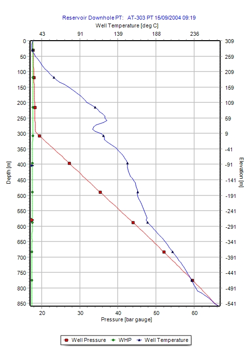

Thank you for your suggestions. The graph of data from a deviated well, using both Depth and Elevation on the vertical axes is now working well - see enclosed project.
However, I have the following questions:
1. Is there a command to auto-synchronise two axes when a vertical axis is specified as aBothVertAxis, or do I have to manually synchronise the axis parameters as shown in procedure TfrmPTChart.SyncVertAxes?
2. I wish to be able to synchronise the grids of the two horizontal axes, as shown by clicking the "Synchronise dependent axes", using the SyncTopAxis procedure. This procedure works, but when implemented the program locks up after two or three zooms. Furthermore, when I uncheck, the top axis does not revert to automatic scaling.
I look forward to your comments

IanF wrote:1. Is there a command to auto-synchronise two axes when a vertical axis is specified as aBothVertAxis, or do I have to manually synchronise the axis parameters as shown in procedure TfrmPTChart.SyncVertAxes?
The only property in your SyncVertAxes that seems to have a noticeable effect in your project is "Increment". I see you've set the Left Axis Increment to 100 at designtime so, if you don't do the same for the Right Axis, they look different.
IanF wrote:2. I wish to be able to synchronise the grids of the two horizontal axes, as shown by clicking the "Synchronise dependent axes", using the SyncTopAxis procedure. This procedure works, but when implemented the program locks up after two or three zooms.
When you add custom labels, at your SyncTopAxis method, you are incrementing the "i" variable rounding the "Increment". Note when the increment is less than 1, this is rounded to 0 so the "i" variable isn't incremented and you are inside an endless loop.
An option would be to change the "i" variable to a double and then avoid some roundings:
    i:=BMin/BInc * BInc;
    repeat
      Tval := Round((i - BMin)/BDiff*TDiff + TMin);
      TPos := (i - Bmin)/BDiff*TDiff+TMin;
      Top.Items.Add(TPos, FloatToStr(Tval));  // adding custom label
      i:=i+BInc;
    until i>=BMax;
IanF wrote:Furthermore, when I uncheck, the top axis does not revert to automatic scaling.
Add this at your CheckBox1Click:
DBChart1.Axes.Top.Items.Automatic:=True;

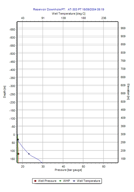

I have one more problem, that I am unable to reproduce in the test program. When I draw my graph, the horizontal grid lines slightly out of sync
. This only occurs if the left axis is set to Automatic scaling. When I scroll using the mouse wheel, the horizontal grid lines synchronize nicely
. However if I use mouse right-click to scroll the graph, the grid line become more unsynchronized.
Clearly I am not setting the Right Axis parameters correctly, but I have tried many options without success.
I would appreciate it if you could suggest some Right Axis settings I should specify to synchronize the grids.

Thank you for your suggestions regarding the lack of synchronization of the left and right axes when I set VertAxis = aBothVertAxis. However, this has nothing to do with the OnGetAxisLabel event, as it occurs even when this event is turned off. The problem occurs only when LeftAxis.Automatic = True.
I find it difficult to understand why the two vertical axes are not automatically synchronized whenever VertAxis is set to aBothVertAxis, as I cannot see the purpose in having one vertical axis with a different range than the other one, when the series is being plotted against both axes. Relabelling an axis does not alter this observation - when I relabel a Depth axis to Elevation, I am stating that this is the Elevation of the corresponding Depth, but the two axes are essentially still synchronized.
However, given that the two axes need to be manually synchronized, I have tried various commands. For instance, as UndoZoom leaves the two axes slightly unsynchronized, I have tried various commands such as:
procedure Tformmain.UndoZoom(Sender: TObject);
var
  AMin,AMax: double;
    if PBQuickGraphMain.IndependentLeft then
      QuickGraphChartMain.LeftAxis.CalcMinMax(AMin,AMax);
      QuickGraphChartMain.RightAxis.Minimum := AMin;
      QuickGraphChartMain.RightAxis.Maximum := AMax;
However, to no avail - the grid lines of the two vertical axes remain slightly unsynchronized, as shown in my previous post. However, mouse wheel scroll (with no defined event) causes the left and right grids to synchronize, which shows that synchronization is possible.
Clearly, I have some settings after UndoZoom that are causing the grids to become misaligned, but I cannot find these, however much I step through the code. I would appreciate any suggestions you might have, so I can get this working correctly.
