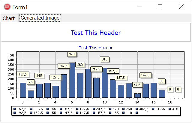

I create images from TCharts to put in my reports (using Digital Metaphors TppReport). Everything is fine when Display/Scale and Input/Change the size of text, apps and other items is at 100%, but when that number changes, all bets are off: fonts appear incorrectly, and the reports simply do not work. It is frustrating.
I have narrowed part of it down to creating imags from TChart (there are some things happening that I haven't quite figured out).
Take a look at the attached demo: when the setting is 100%:
the caption on the chart caption is the correct size (compare it against the size of the TLabel just above it, which is the same font and text):
but when I change it to 200%, the image is rendered without the correct font size:
The report needs the fonts rendered the font size for printing, not for the display settings.
Demo is attached.
Any suggestions on how to get this to work correctly?

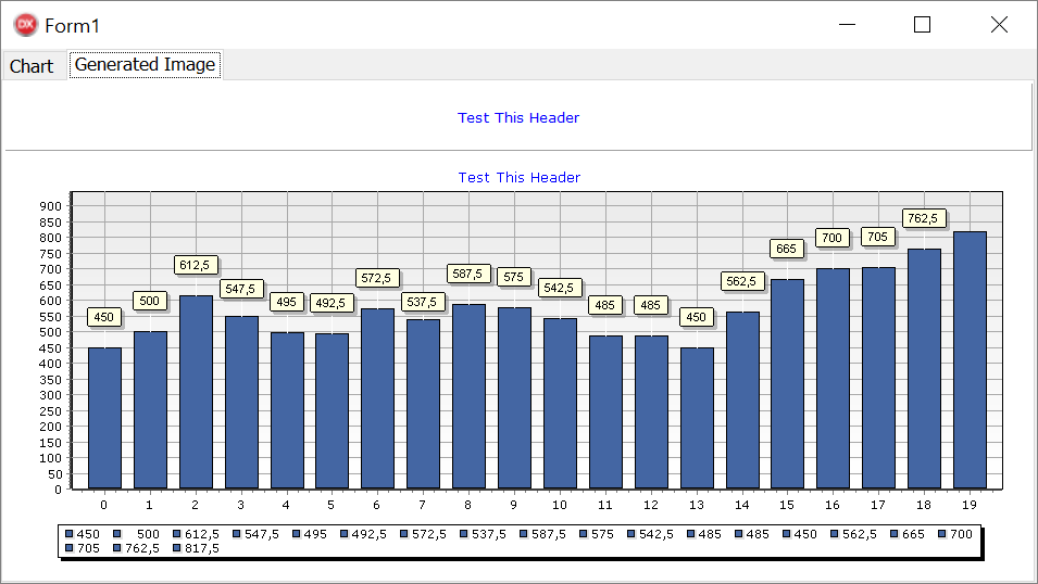

Fin below my results with TeeChart v2018.24 setting the scale to 150% (I can't set it to 200%).
First I've ran the application and changed the scale "on the fly":
1. onTheFly.png (19.1 KiB) Viewed 39975 times
This is what I get if I close and reopen the application:

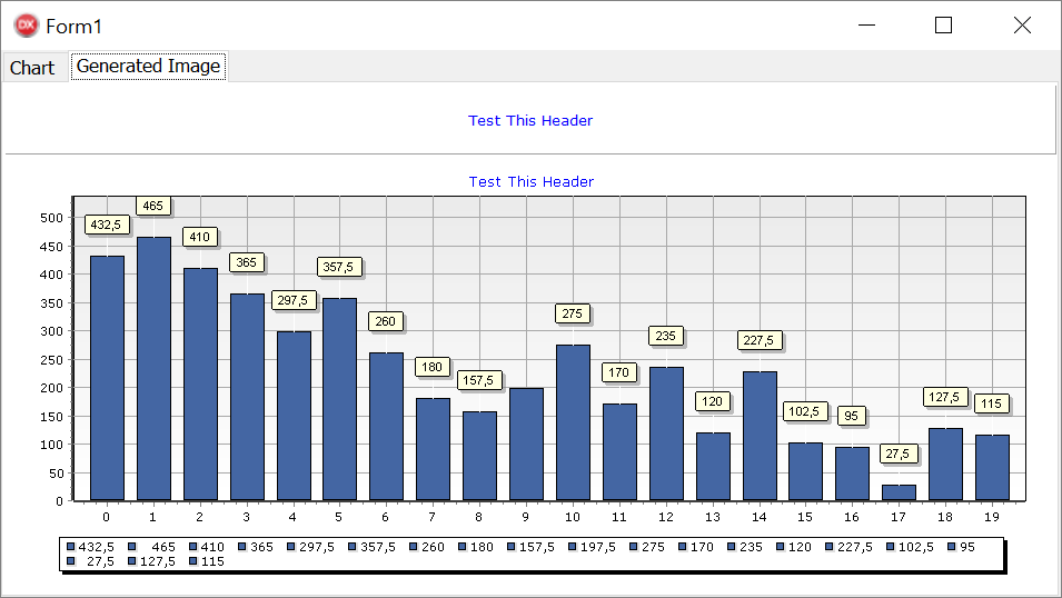

And this is what I get when I open the application after rebooting at 150%:
3. reboot.png (27.67 KiB) Viewed 39970 times
