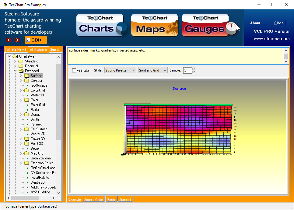

It gives a proportional look when you disable the orthogonal property. Here a surface at 50%:

Thanks, but I would like to know what it is proportional to. I need to be able to exactly control the 3D effect. For scientific charts they have to be geometrically correct - not just look nice. That is true for a mathematical surface where the height of a surface depends on the units for the variables. However my actual application uses 3D points.

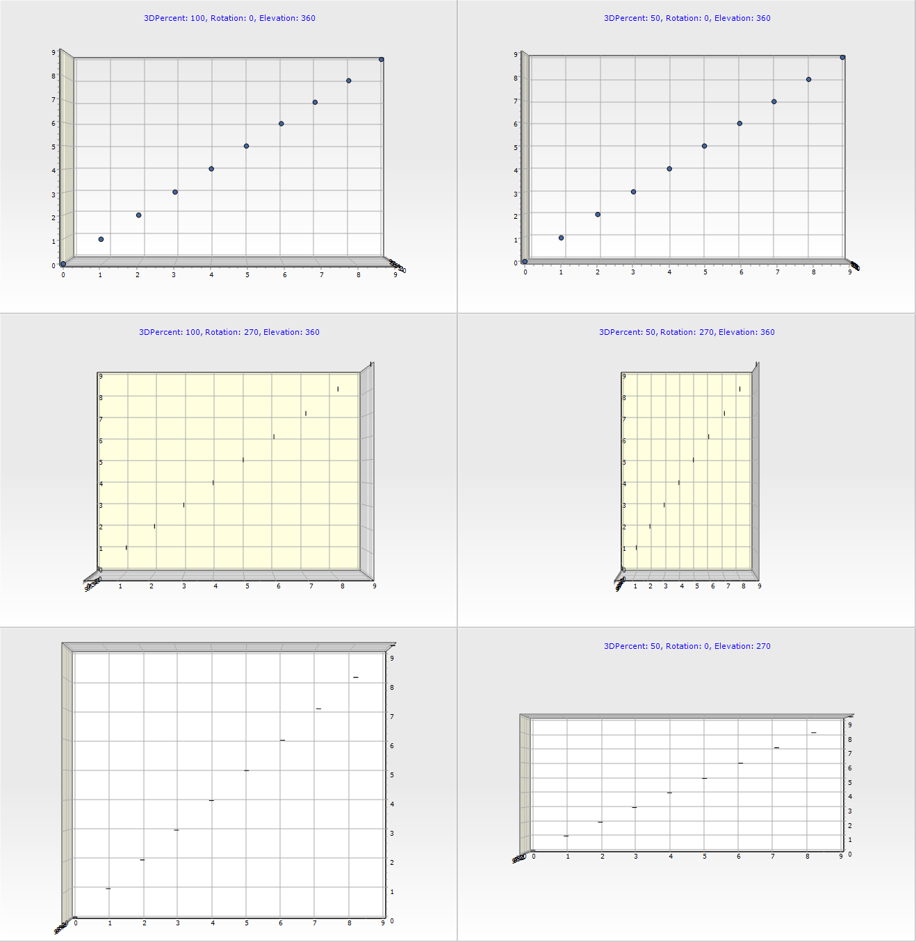

And I got these screenshots, which seem correct:

Well, just any 3D chart example where the lengths of all 3 axes should look to be at the same scale for any rotation. That is, a cube must be seen as a cube for any rotation and a sphere still a sphere. That is, it should give an orthographic view for any rotation. See https://en.wikipedia.org/wiki/Orthographic_projection.
It should also use perspective properly. The present code cannot be used for a true perspective view because I only see one parameter to control the apparent depth (the percent parameter). For true perspective (see https://en.wikipedia.org/wiki/3D_projec ... projection) one has to be able to specify the location of the viewer relative to the object being plotted.
I hate to be a pest about this but these two options are essential for many types of scientific plots. I hope at least the orthographic projection could be implemented soon - though then adding perspective is just a simple addition to the projection equations.
Oh, and note also that the code in the Calculate3Dposition and Calc3DPoint functions assume square pixels. visually, probably not so important but it really should be included.
