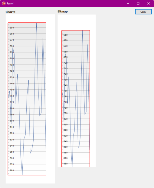

I have been trying to achieve the following, but I can't get close (unfortunately the Help is correctly installed and/or helpful either):
I wish to develop a custom graphic object/component that embeds a TChart (just the Chart Rectangle that is). In its most simple form, it would look like show below.
Note I have shrunk the "graph" slightly in order to show all borders. Other (derived) objects will be more complex, obviously.

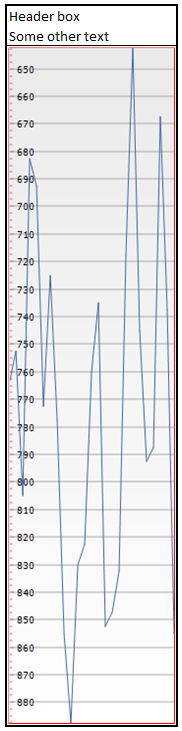

The idea is that the ChartRect (re border area) of an "off-screen" TChart (memory) is either copied or drawn to a different canvas (controlled by the custom object/component).
So far I have tried to simply copy the ChartRect to a custom bitmap (TImage), but I have not been successful.
Example 2.png (63.17 KiB) Viewed 34733 times
The code I have used for this (in many variations) is attached to the button:

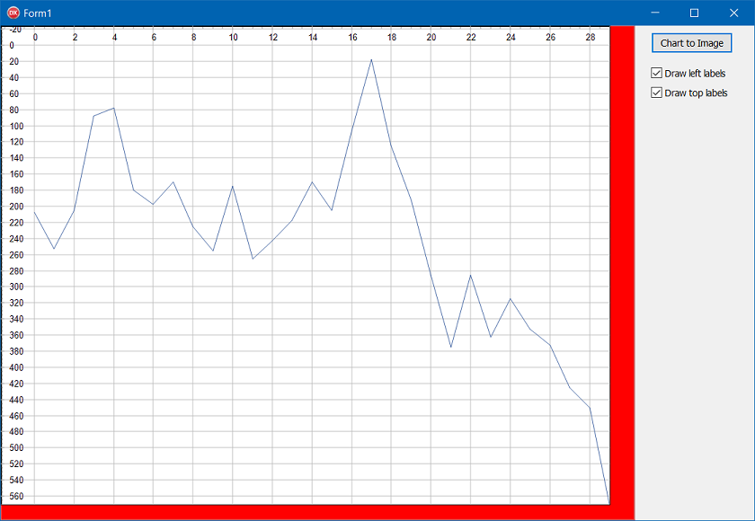

It's still not functioning the it should. I have slightly modified your proposed approach and added a design-time (visual) TChart.
This results in in two notable issues;
1. If you click the button ('Chart to Image') twice (without changing form size), you'll see a distinct difference.
2. If you click the other button ('Rectangle'), you'll see a red rectangle, sized to the ChartRect of the visual TChart - exactly the area I want to copy (as bitmap) from the off-screen TChart.
