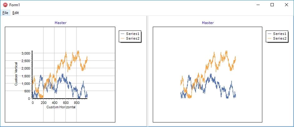

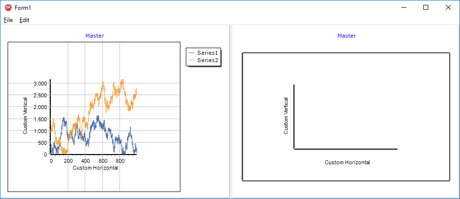

If there are custom axes on a chart, CloneChart does not copy them. The only way to duplicate such chart appears to be Save it to Stream and Load the stream in the new chart.
if Master is the original chart and clone is its duplicate, I get the following results:
Clone.Assign(Master):
  CloneChart(clone, master, self, FALSE):
When I use save to/load from stream, I get proper results. A simple project is attached. Use Edit->Copy(Assign), Edit->Copy(Clone) and Edit->Copy(Stream) to see the effects.
