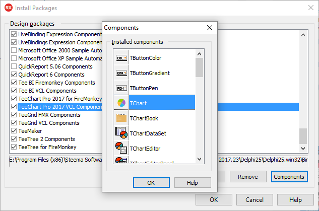

Although the install seems to works fine it leaves behind the previous TeeChart Std folder in the toolbar palette.
Although it does create a TeeChart folder in the tool palette, the new version of the main TChart component is left behind in the TeeChart Std folder.
Although the library paths are correct they don't work.

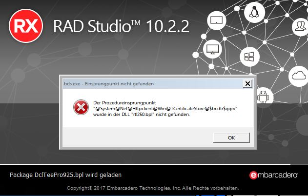

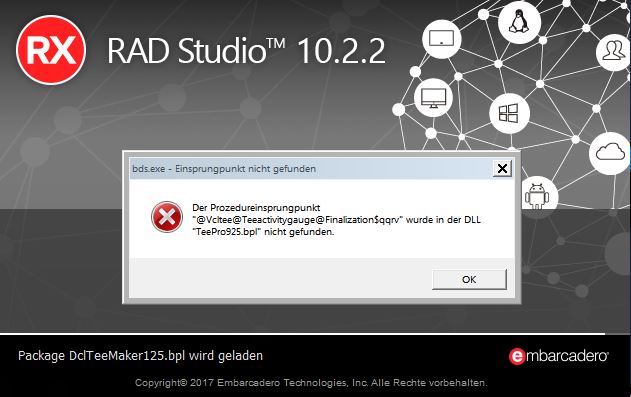

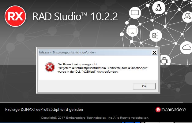

I also tried it without other additional Packages, with and without TeeStandard and the latest TeeChart2017.23 Source Recompile Version.
That happens when i try to Start Delphi:

Metman wrote: Although the install seems to works fine it leaves behind the previous TeeChart Std folder in the toolbar palette.
If the Pro installation ended successfully, the design time pacakges should have been replaced, even if the TChart component hasn't moved to the new folder in the toolbar. Note you can drag and drop the components in the toolbox.
To know what components you have installed, check the list of packages, not the toolbox.
So, even if the installation should have moved the TChart component to the new folder in the toolbox, if it fails, you can move it manually or you can leave it where it is.

Metman wrote:Is this problem somehow related to Update 2?
Yes. Note Embarcadero published RAD Studio Tokyo Release 2 (25.0.28979.1978) and a few days later they published an important Hotfix (25.0.29039.2004) (ref here):
We have updated RAD Studio 10.2.2 to address an issue that caused incompatibility problems for a number of third party components.This build (build 2004) replaces the previously released RAD Studio 10.2.2 build (build 1978).
We released TeeChart v2017.23 after this hotfix was publised, so:
- TeeChart v2017.22 binary version supports RAD Studio Tokyo Release 1 (not Release 2 with or without the Hotfix).
- TeeChart v2017.23 binary version supports RAD Studio Tokyo Release 2 with the Hotfix, not any previous version.
- There's no TeeChart binary version supporting RAD Studio Tokyo Release 2 without the Hotfix.
- Both TeeChart v2017.22 and v2017.23 source code versions support all RAD Studio Tokyo versions: Release 1, Release 2 without the Hotfix and Release 2 with the Hotfix.

web wrote:I also tried it without other additional Packages, with and without TeeStandard and the latest TeeChart2017.23 Source Recompile Version.
Do you get the same messages if you open the IDE with high privileges (as administrator) and with no project loaded?
Are you using RAD Studio Tokyo Release 2 Starter, Pro, Enterprise or Architect?
