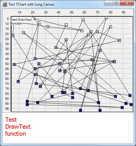

Since i've upgrade my RAD from D2009 to XE10.1 and Teechart from 8.08 to 2017.10, DrawText function (from winapi unit) no longer use canvas settings as font color, size, etc...
Same function on TImage canvas works fine!
Please find attached small project highlighting problem.
I use Delphi XE10.1 and TeeChart Pro VCL FMX Source Code 2017.20.
Thanks for your help
Anthony
TestTChartLDrawText - XE10.1.zip
(25.96 KiB) Downloaded 1500 times
