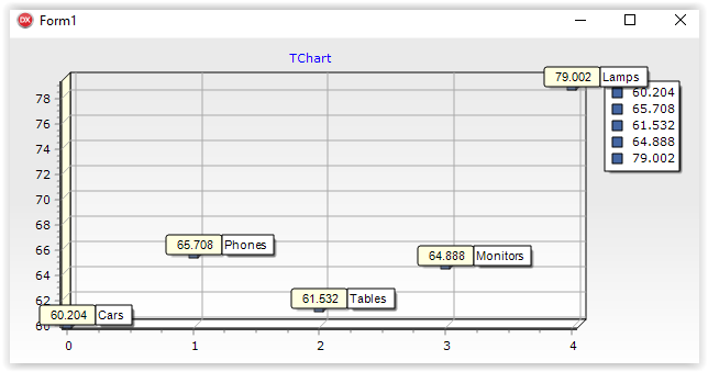

Thanks but this does not yet give me what I want. I have attached a screenshot below.
Two problems. First, It puts the labels to the right of the values that label each mark. I need the labels to be to the right of each point not the labels for the marks.
Second, when I run the program the annotations are initially all on top of each other at the top left of the chart until I move the mouse over one of the points. They then snap to the positions shown in the screenshot. Do I need to set some options for the TChart? My form just has a TChart component dropped onto it and then set to align with the client. No other changes to the form.
My code (copied from your second example) is given below.
Thanks for your help.

- Screen Shot 10-26-17 at 11.26 AM.PNG (18.23 KiB) Viewed 14918 times
Re: labels for marks
An image could help to clarify the goal.
I'm not sure to understand if you want to also show the default marks or not. If you don't want to show the default marks, you can just modify their text and position without needing to use TAnnotationTools.JimR wrote:First, It puts the labels to the right of the values that label each mark. I need the labels to be to the right of each point not the labels for the marks.
It also fails to correctly reposition the annotations when you zoom and unzoom. this happens because the TAnnotationTools are drawn earlier than the series in the drawing center; so the annotation positions that are calculated in the SeriesGetMarkText will apply at the next repaint. To solve it, you can force a chart repaint when these events happen. Ie:JimR wrote:Second, when I run the program the annotations are initially all on top of each other at the top left of the chart until I move the mouse over one of the points. They then snap to the positions shown in the screenshot. Do I need to set some options for the TChart? My form just has a TChart component dropped onto it and then set to align with the client. No other changes to the form.
