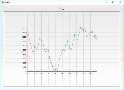

According reference http://www.teechart.net/docs/TeeChartVCLReference.htm, Grid zoning (defined with UsePartnerAxis, PartnerAxis) permits the pairing of Axes so that Gridlines plotted from either Axis are delimited by the zone of the partner. But at least in version 2017.21.170329, when 2 custom axes are used, the grid lines are through the whole chart. see:
. Desired:

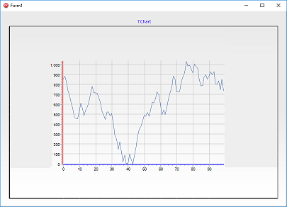

This is what I get with your code in TeeChart Pro v2017.22:
I only added this to your code:
  Chart1.View3D:=False;
  Chart1.Legend.Visible:=False;

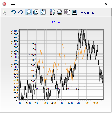

Chart1.View3D:= FALSE sorts the problem until we put TTeeCommander.
As soon as drag/zoom buttons of TTeeCommander are used - the chart switches to 3DView mode and the grid is not clipped anymore. Some time ago I found a suggested solution for this problem to keep the chart in 3DView mode with 1% (may be by you).
That's right. It works as you wish for 2D only, also with the default axes:
