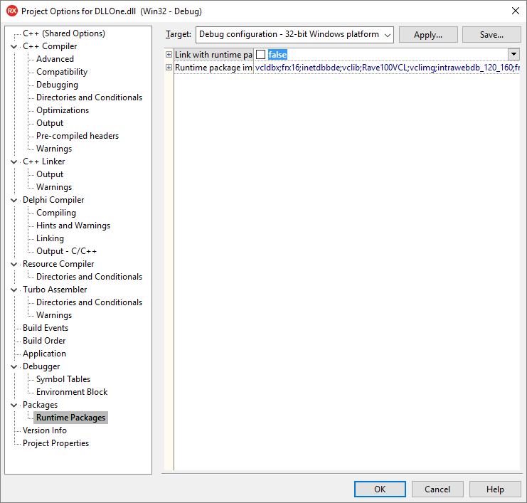

I believe this is similar to this old topic.
Try unchecking "link with runtime packages" in all the dlls.

RG Solutions wrote:In the test case that I sent, it has both the DEBUG and RELEASE builds. The DEBUG build uses "static" linking for the DLLs, and the RELEASE build uses "dynamic" linking for both DLLs. The problem still occurs whether you use "static" or "dynamic" linking.
I meant the "link with runtime packages" option here:

Regarding your suggestion about make "Link with runtime packages" false. This is great if you have a single DLL or no DLLs at all. However, if you are using multiple DLLs it is almost always necessary to "Link with runtime packages" for two reasons. The first is the size of the files. When you have 34 different object files as part of the install, this takes up a huge amount of extra disk space. The second issue is that with multiple DLLs, if they are not "Linked with runtime packages", then you most surely will have VCL conflicts and the program will not run. The only way I have been able to make my processing run is linking with runtime packages.
Now on to the original issue. The issue with the test case I sent was very subtle. When someone sets "Link with runtime packages" to true, one would assume that all packages used by the processing would be "runtime linked". The truth is that when this option is set to true, it will only link the packages that are included in the accompanying list. This means that in the test case I included, all the VCL packages would be runtime linked, and the TeeChart packages would be statically linked because they were not in the list. Mixing static and run linkages in the same object module does not seem to work well. For this reason, it is necessary to add the TeeChart packages to the list. In the test case, it was necessary to add "Tee925 and TeeUI925". The 925 must be present otherwise the package in the list is not found and is statically linked. If you add these two statements to the two DLLs, the test case will work.
