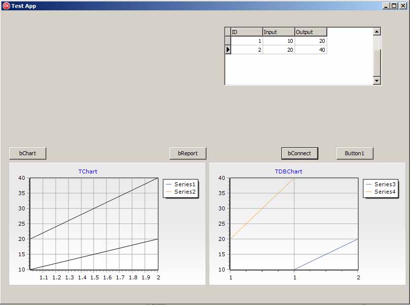

When using TDBChart in VCL I’m not getting the expected output. I get two separate X’s for the two series.

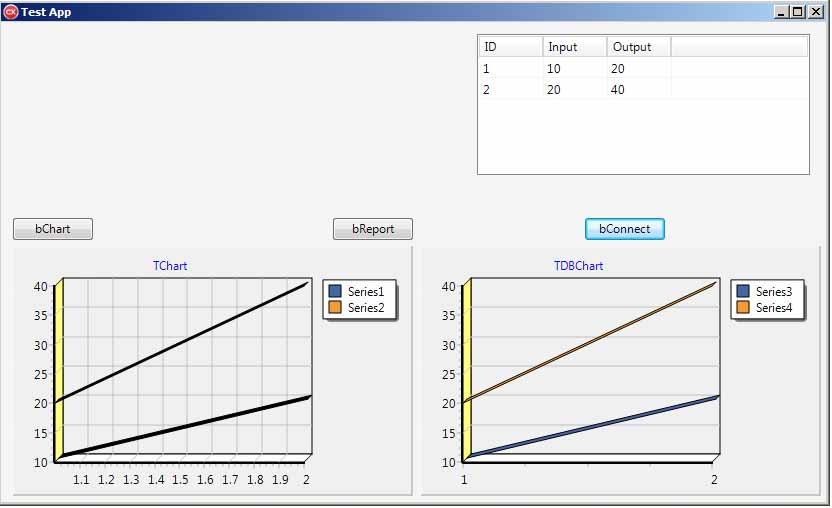

Works ok in FMX.
How to I resolve this?
Thanks, Alan

Re: TDBChart in VCL
Post by Yeray » Tue Jul 04, 2017 8:34 am
I haven't looked at the FMX version yet, but I see in the VCL version, this seems to fix the problem:
 Series3->XValues->ValueSource = "ID";
 Series4->XValues->ValueSource = "ID";
Note you assigned the Labels and the YValues source of the series in the TDBChart, but not the XValues source.
Re: TDBChart in VCL
Post by Yeray » Tue Jul 04, 2017 9:20 am
I see in the dfm in your VCL project Series3 has XLabelSource and YValues.ValueSource defined.
    object Series3: TLineSeries
      XLabelsSource = 'ID'
      YValues.ValueSource = 'Input'
Removing those 2 lines from the dfm the problem disappears.
pcs_user
Posts: 4
Joined: Tue Nov 08, 2016 12:00 am
Re: TDBChart in VCL
Post by pcs_user » Thu Jul 06, 2017 8:47 pm
That works,
