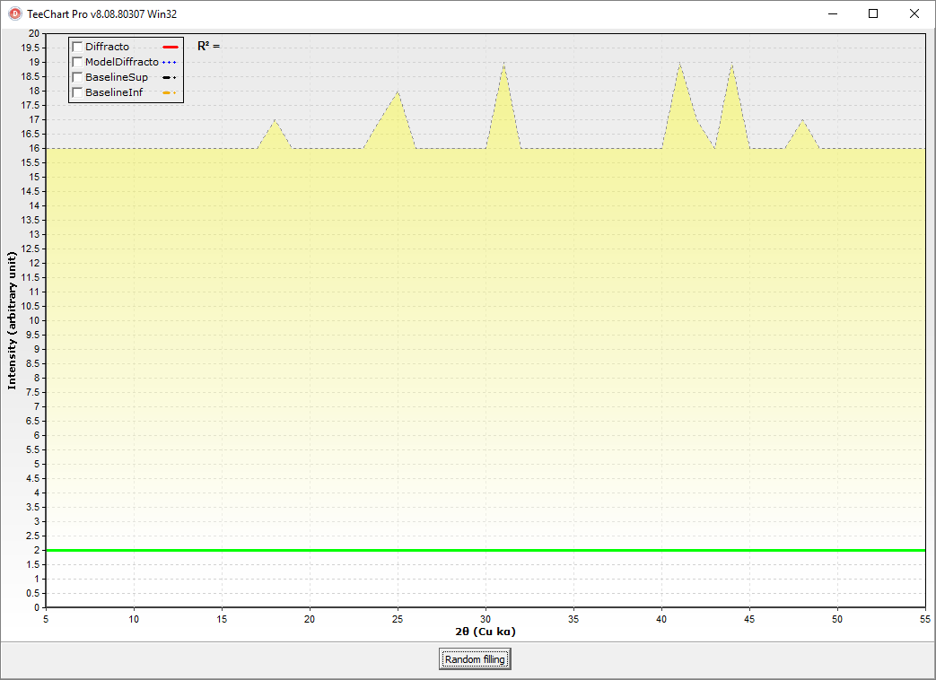

Thomas wrote: - the second issue, by unchecking on the legend serie checkbox, the serie band remain visible (on TeeChart VCL 8 it is synchronized, both serie and its band are visible or not driven by legend click)
With v8.08 I get a band still drawn, even if all the series are disabled:
I could reproduce and identify the problem here:
http://bugs.teechart.net/show_bug.cgi?id=1836
