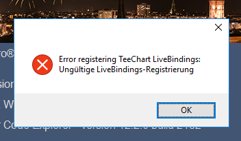

I've disabled Live Bindings in Delphi 10.1.. It did this because of massive performance problems in bigger projects. I did it the following way: Removed / disabled the three Live Bindings packages from embarcadero.
Since it did that TeeChart Pro complains at every start about it: "Error registering TeeChart LiveBindings: Invalid registration". I tried to bypass this with reinstalling the TeeChart components, but i had no success.
Is there anyway to disable / get rid of live bindings in teechart pro, too?

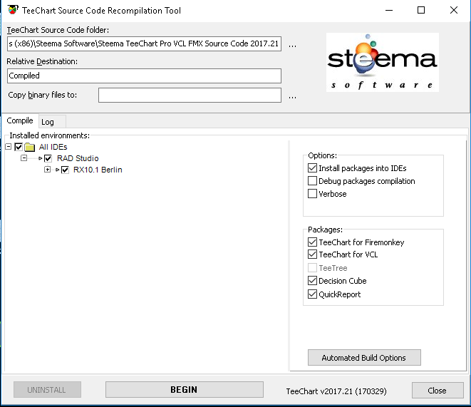

I can't find any checkbox in the recompile tool
Re: Disable Live Bindings
Post by Yeray » Wed Apr 05, 2017 7:16 am
Winweb wrote:I can't find any checkbox in the recompile tool
I'm afraid the new checkbox didn't get into the v2017.21 release.
I'll send you a mail with the current TeeRecompile version.
