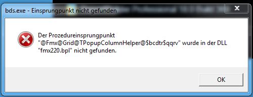

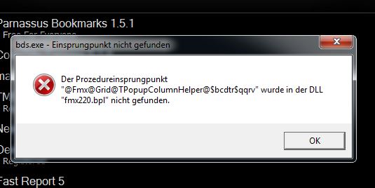

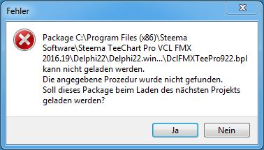

After installing the newest TeeChart on my Win7/Delphi XE8 system, Delphi reports some errors at start, se attachments.
Removing and reinstalling Teechart using TeeInstall.exe does not change this.
I found that fmx220.dll is located in 4 folders on Delphi XE8,
c:\Program Files (x86)\Embarcadero\Studio\16.0\bin\fmx220.bpl
c:\Program Files (x86)\Embarcadero\Studio\16.0\bin64\fmx220.bpl
c:\Program Files (x86)\Embarcadero\Studio\16.0\Redist\win32\fmx220.bpl
c:\Program Files (x86)\Embarcadero\Studio\16.0\Redist\win64\fmx220.bpl
Filedate is 2015-03-18 which is probablay the reason for the errors.
If I rename these file Delphi complains and refuses to start.
A complete deinstallation and reinstallation of TeeChart did not change the situataion.
How can I get rid of the old fmx220.bpl ?

Re: Installation problem TeeChart 2016.19.161025 VCL/FMX
Hello Gerhard,
I read you mentioned TeeInstall, but I see you own TeeChart source code version.
Are you getting this error when installing TeeChart sources, using TeeRecompile.exe?
Hello Yeray,
installing TeeChart from Sourcecode was successfiull.
First I deinstalled the old version, installed sourcecode and ran TeeInstaller.
It claimed about a missing OSX compiler which I dont have and dont need.
After that I had to reinstall ReportBuilder and now it works.
Thank you
