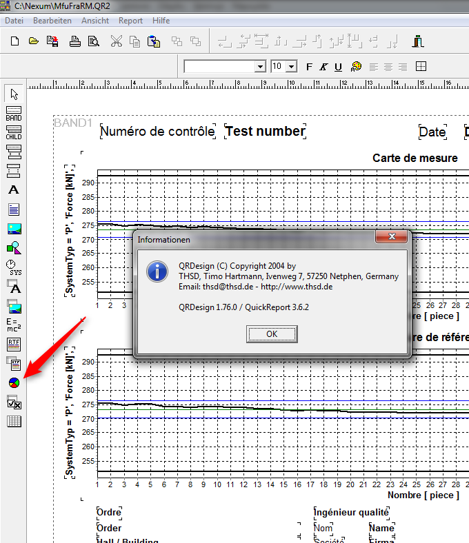

I need it works the same way as in the old version of quick report designer...see attached print screen of an old quick report designer, there is teechart integrated

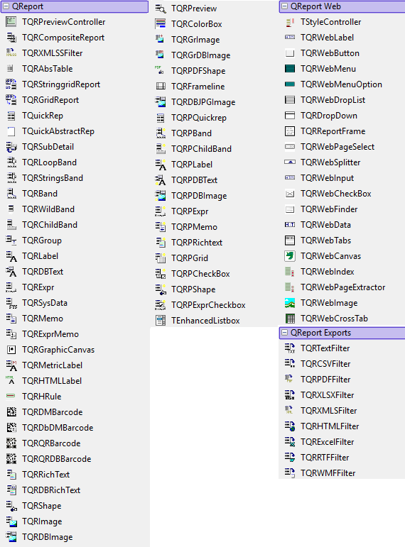

I've tried to use this unit in a Delphi 7 with QuickReport 5 installed, but I can't find any TQRepDesigner in my installation.
This is the palette I see in QuickReport tab:

Here the list of components I get for QuickReport 6 Pro for RAD XE 10.1 Berlin. I can't find any *Designer*:

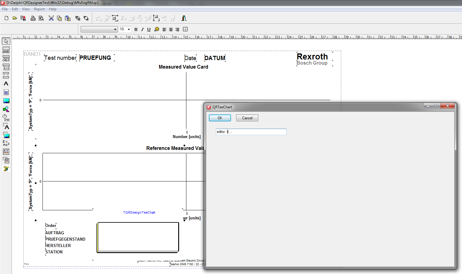

I found the problems, it works now some how... I miss border on the first chart...
Do you have a hint how to create chart editor fastly/ easily?

Franta wrote:Do you have a hint how to create chart editor fastly/ easily?
The editor can be called as follows:
uses EditChar;
   EditChart(Self, QRDBChart1);
However, note the editor is designed to help the developers to build and test their applications, not to be accessed by the final users, so we don't recommend giving access to it.

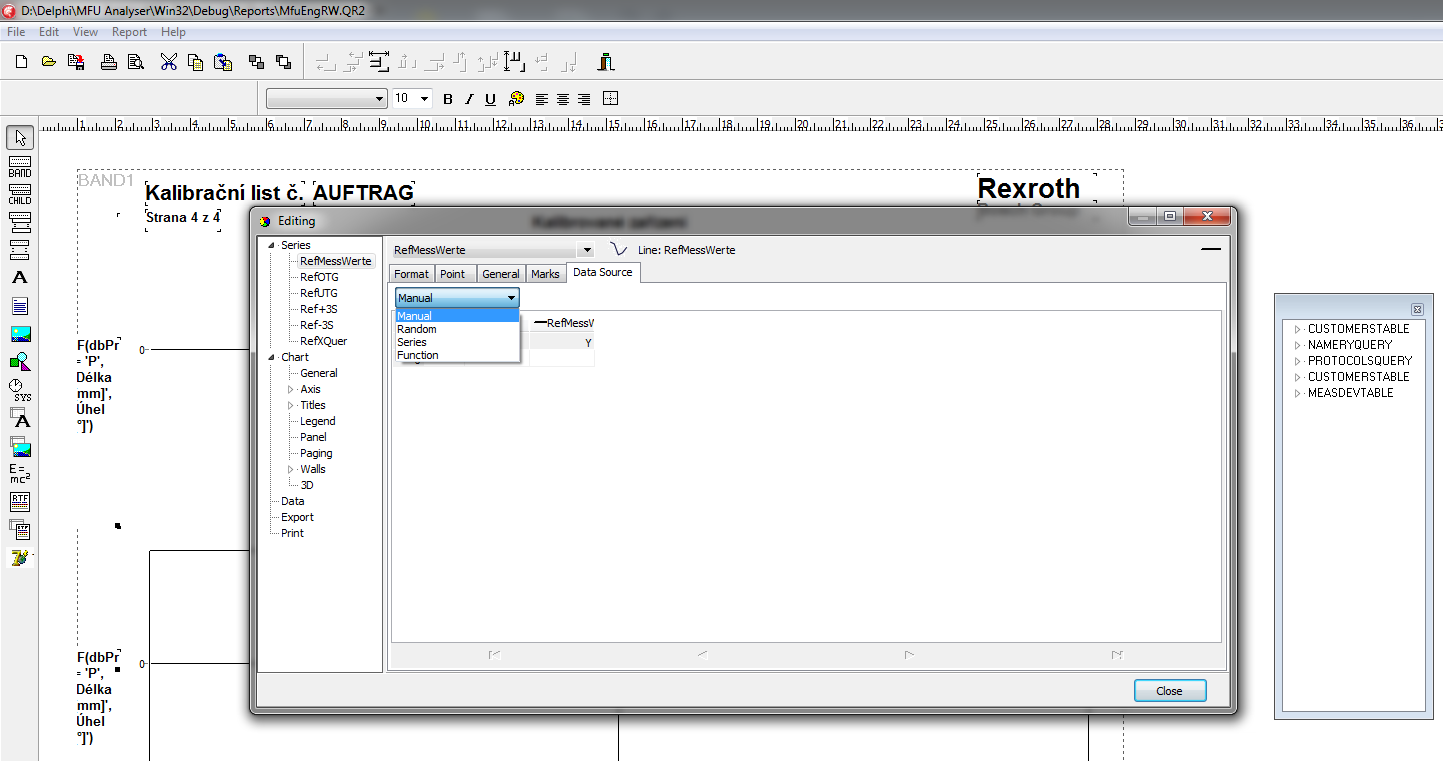

EditChart works fine, but I miss Dataset in series/datasource
How can I add dataset? and how add list of tables...
(in Delphi IDE dataset and tables are available)
