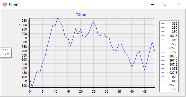

Incorrect axis title position when angle = 0 and TextFormat = ttfHtml (multi line)
Here Is a simple example
void __fastcall TForm1::FormCreate(TObject *Sender)
	Chart1->View3D = false;
	TLineSeries* pTLineSeries = new TLineSeries(Chart1);
	Chart1->AddSeries(pTLineSeries);
	pTLineSeries->FillSampleValues(50);
	Chart1->LeftAxis->Title->Text = "Line 1<BR>Line 2";
	Chart1->LeftAxis->Title->TextFormat = ttfHtml;
	Chart1->LeftAxis->Title->Transparent = false;
	Chart1->LeftAxis->Title->Angle = 0;

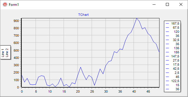

When Angle = 90 the position is also incorrect or left margin is to small (it depends on current chart size)

You can fix the Title Axis position when the Angle is 0, changing the left margin size in same way as code below:
	Chart1->LeftAxis->Title->Angle = 90;
	TeeGDIPlus1->TeePanel = Chart1;
	TeeGDIPlus1->Active = true;
	CheckBox1->Checked = true;
	Chart1->Draw();
	//ChangeMargins size
	Chart1->MarginUnits = muPixels;
	TRect* rect1T = new TRect();
	rect1T = &Chart1->LeftAxis->Title->ShapeBounds;
	Chart1->MarginLeft = Chart1->MarginLeft+ rect1T->Width();
Hoping this helps
