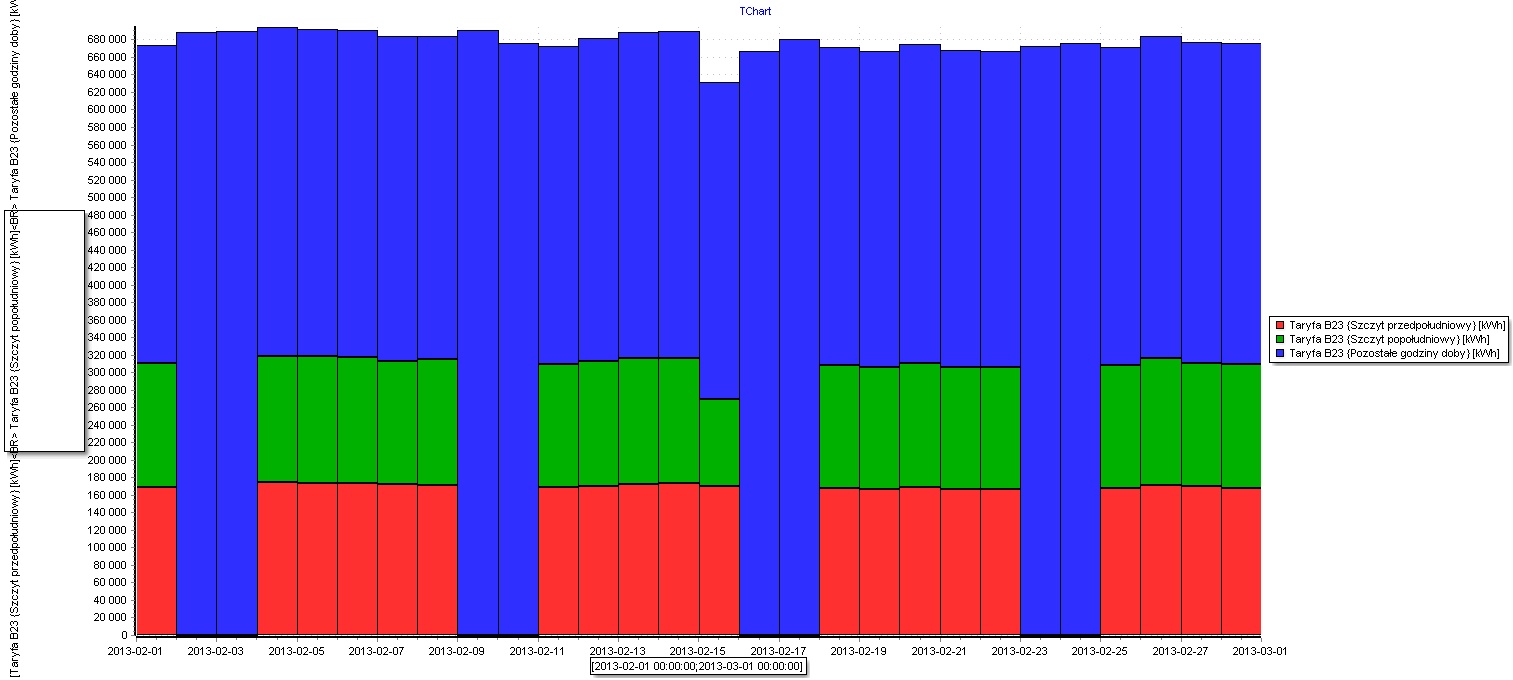

As you can see on that picture the frame behaves correctly but the text dose not breaking the line ( <BR> tag ).

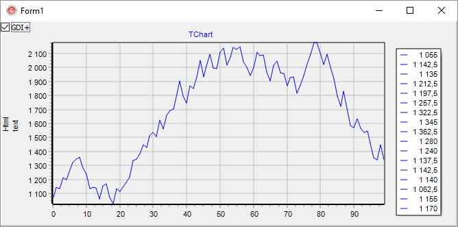

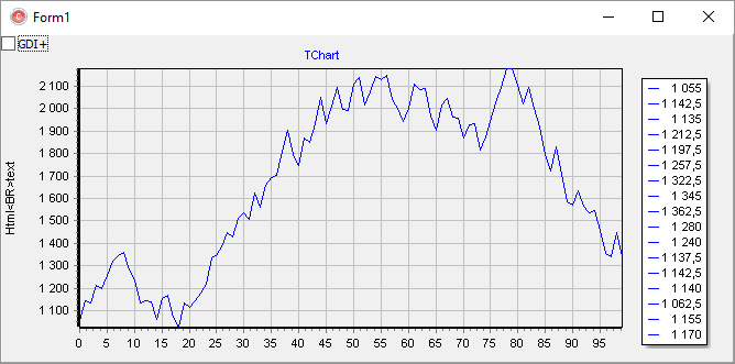

But You have to use html tag <BR> in text eg.
Chart1->Axes->Left->Title->Text = "Html<BR>text";
GDI+ enable
GDI+ disabled

Re: Axis title text doesn't obey html format
Post by Sandra » Tue Jan 17, 2017 9:23 am
Hello Technicon,
Many thanks for the update information.
After reviewing that again, I would like inform you the proble is already added in TeeChart VCL bugzilla tracker. Here's the link: http://bugs.teechart.net/show_bug.cgi?id=1343.
