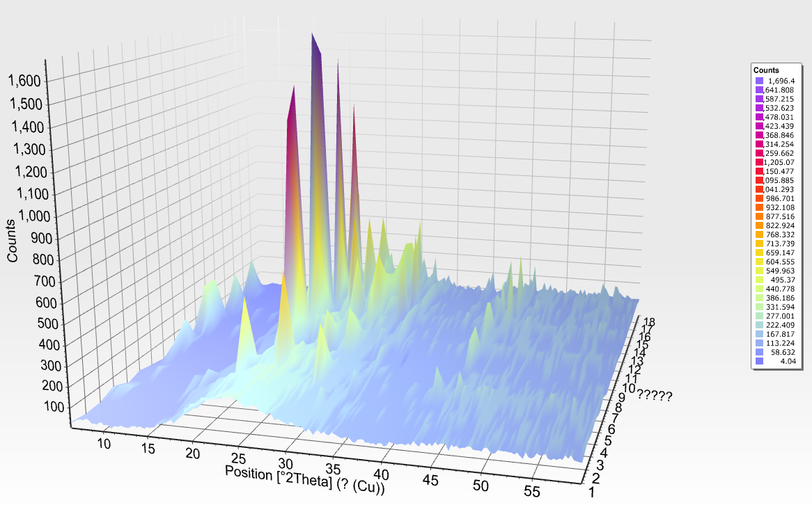

I just noticed that when we use Unicode text (Japanese, Chinese for example) for TChart in OpenGL mode that
the Axis labels are wrongly painted:
We are using Delphi Seattle Update 1 and TeeChart Pro v2016.19.161025 32bit VCL
Is that Unicode problem "by design" or can/will it be solved ?
best regards,
X-ray

I'm afraid OpenGL doesn't support double-byte charactersets, it is not Unicode compliant.

I think a possible solution for this is to draw the (Unicode) text to an image and use that image as a texture.
In that way it's possible to paint any Unicode character.
best regards,
X-ray
