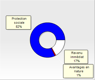

Hello.
I use the following code to generate donuts. I have little room to generate my graph.
	TChart * Chart1 = new TChart(this);
	Chart1->Parent = this;
	Chart1->View3D = false;
	Chart1->Width = 270;
	Chart1->Height = 245;
	TDonutSeries* serie = new TDonutSeries(Chart1);
	serie->CustomXRadius = 47;
	serie->CustomYRadius = serie->CustomXRadius;
	serie->Legend->Visible = false;
	serie->Add(82, UnicodeString("Protection \r\n sociale \r\n 82%"), clBlue);
	serie->Add(1, UnicodeString("Avantages en \r\n nature \r\n 1%"), clRed);
	serie->Add(17, UnicodeString("Revenu \r\n immédiat \r\n 17%"), clWhite);
	Chart1->AddSeries(serie);
One of the marks is not positioning correctly. She leaves the panel, while she might be positioned elsewhere. I suspect that the positioning algorithm may not be easy to manage, but maybe you can improve it.

Indeed the antiovelap algorithm could be improved to better handle some situations. However the more complex the alrogirthm, slower it will be.
Have you tried using the TDragMarksTool to manually position your marks?
(I'm not sure why some programs show the blue in that screenshot as purple :roll: )

Thank you for your reply.
Your solution is interesting, but alas in our situation, the graphics are not visualized. They are generated, exported as an image and integrated into a document.
Using the TDragMarksTool is not possible.

Here a simple example:
uses Series, TeeDonut, TeeTools;
var tmpRect: TRect;
  Chart1.View3D:=False;
  Chart1.Legend.Visible:=False;
  Chart1.Title.Visible:=False;
  with Chart1.AddSeries(TDonutSeries) as TDonutSeries do
  //with Chart1.AddSeries(TPieSeries) as TPieSeries do
    Add(82, 'Protection'+sLineBreak+'sociale'+sLineBreak+'82%', clBlue);
    Add(1, 'Avantages en'+sLineBreak+'nature'+sLineBreak+'1%', clRed);
    Add(17, 'Revenu'+sLineBreak+'immédiat'+sLineBreak+'17%', clWhite);
  Chart1.Tools.Add(TDragMarksTool);
  AntiOverlap;
procedure TForm1.AntiOverlap;
var R1,R2,DummyRect: TRect;
    i, j: Integer;
    mp1, mp2: TSeriesMarkPosition;
  Chart1[0].Marks.Automatic.Move:=false;
  Chart1.Draw;
  mp1:=TSeriesMarkPosition.Create;
  mp2:=TSeriesMarkPosition.Create;
  for i:=0 to Chart1[0].Count-1 do
    mp1:=Chart1[0].Marks.Positions.Position[i];
    for j:=0 to Chart1[0].Count-1 do
      if (j<>i) then
        mp2:=Chart1[0].Marks.Positions.Position[j];
        R1:=mp1.Bounds;
        R2:=mp2.Bounds;
        while (IntersectRect(DummyRect, R1, R2)) do
          mp1.Custom:=true;
          mp1.LeftTop.x:=mp1.LeftTop.x+4;
          mp1.LeftTop.y:=mp1.LeftTop.y+4;
          mp1.ArrowTo.x:=mp1.LeftTop.x+4;
          mp1.ArrowTo.y:=mp1.LeftTop.y+4;
          R1:=mp1.Bounds;
          R2:=mp2.Bounds;
        Chart1.Refresh;
It gives a better result, but you could probably improve the algorithm to better fit your needs.
