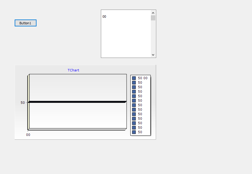

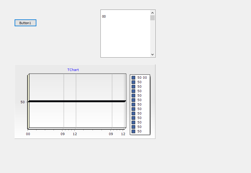

I'm not sure to understand the problem here.
I'm getting the same result in both RAD 10 Seattle and in RAD 10.1 Berlin.
After one click on the button: After 2 clicks on the button:

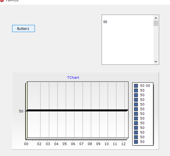

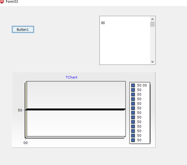

I didnt mean for you to do 2 clicks
(as the data is not cleared between clicks)
i have attached 2 screen shots, after clicking on button1 once
first is when using seattle, second using berlin
with berlin there is no time stamps on the x axis as there is with seattle (same code)
that is the problem
not sure how I could make it more clear
that is the problem
- graph2.png (9.07 KiB) Viewed 31065 times
- graph1.png (10.47 KiB) Viewed 31069 times
