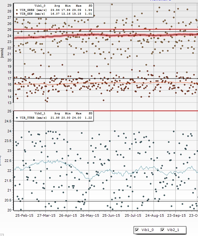

I have an application with a number of lineseries in a chart plotted against multiple vertical axes (vertically stacked). Per vertical axis I would like to have a legend to show the series names linked to that axis. See the attached image example.
I can use the Legend's FirstValue and MaxnumRows properties to have the extralegends show a subset of the series, but this only works as long as the series are distributed over the Y axes in the same order is in the parent Chart's SeriesList. If for example I would like to have the 1st series on the 2nd Y axis it would not work anymore.

If you only want to show the series titles (or some other text related to each series) you could use 2 TAnnotationTool(s) as in the following simple example:
