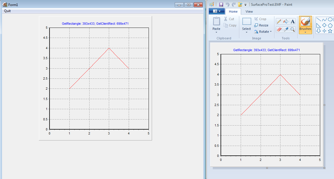

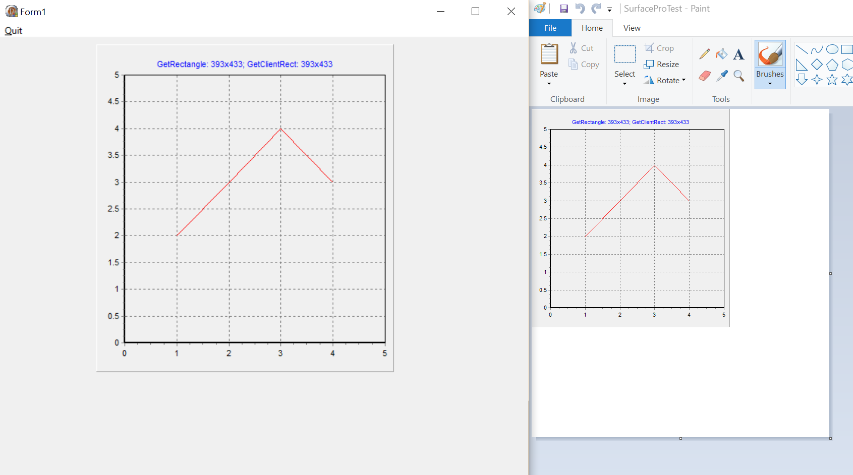

Re: Problems with EMF files on Surface Pro
Here are the results for Win 7 and for the Surface Pro Win 10
- Surface Pro Program on Win 7.PNG (50.33 KiB) Viewed 21178 times
- Surface Pro Program on Surface Pro.png (103.88 KiB) Viewed 21178 times

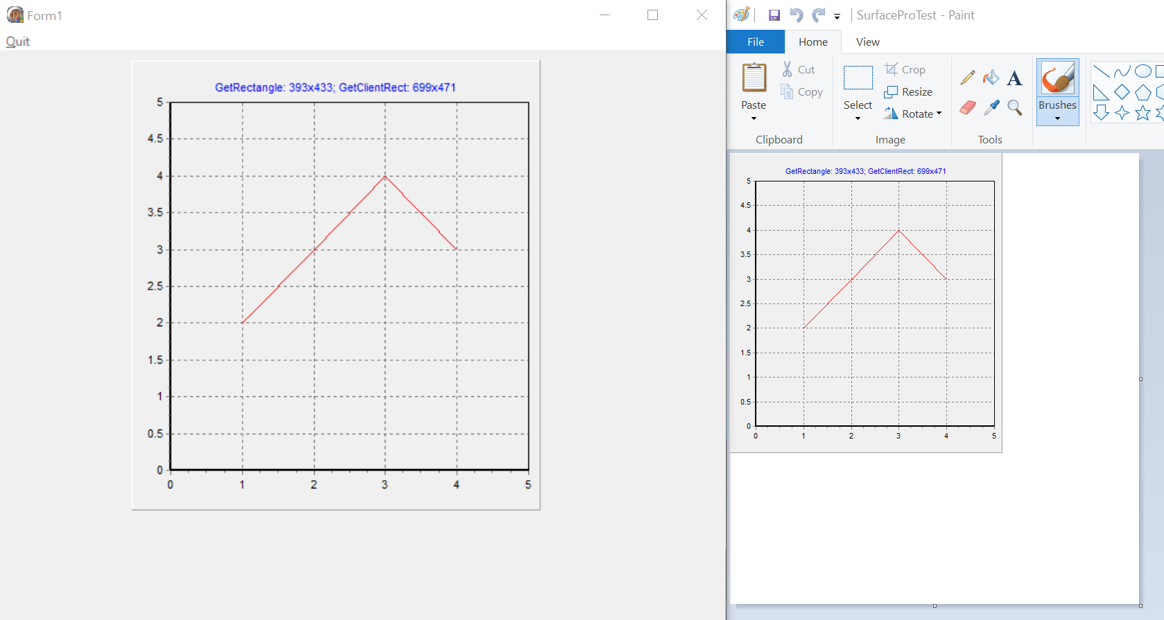

This is the Surface Pro result using the new source code you provided.
- Surface Pro Test on Surface Pro.png (101.01 KiB) Viewed 21179 times
These results make me think again there must be some scaling issue. And I see some changes are giving problems to some devices:
https://blogs.technet.microsoft.com/ask ... ary-update
Could you please tell us what exact Windows 10 build is the Surface Pro 3 using?
