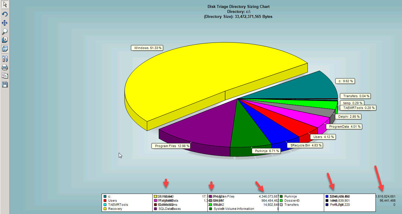

The issue is when the Legend is at the bottom
Example of Bad Legend
Here you can see that the #s in the legend are mixing with the text from the next graph element.
Now what I am displaying here are directory names and their sizes. The value being added as a pie slice is a INT64 - so it 'could' be a large number - but not in these cases.

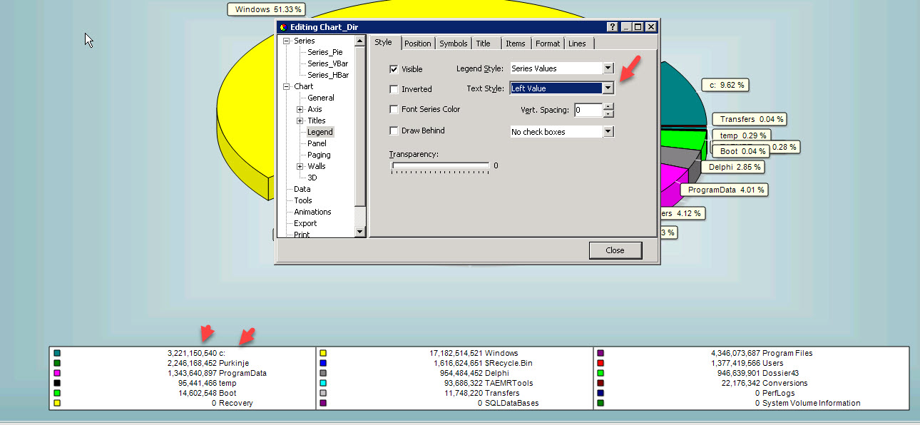

Another example shows what it looks like when I put the Text Style to Left Value.
Here you can see that the Numbers no longer over write the Text - which is nice - but there is a lot of space between the little images and the number. now I am guessing that this has to do with them being INT64 numbers? But I am not sure.
Is there a way to have the legend display Right value - and display properly... IS there a way to prevent the numbers in the legend from having so much space in front of them? (I looked for some sort of format for the values - but did not see anything).

I could reproduce the problem modifying a bit the test project in the ticket #1430.
I'll see if I can find a rapid fix for it or if I have to reopen the ticket (or to create a new one).

I've created a new ticket for this issue:
http://bugs.teechart.net/show_bug.cgi?id=1643
Posts: 9715
Re: Legend not displaying properly when at Bottom
Post by Yeray » Fri Oct 07, 2016 9:58 am
This is just to inform we've just fixed and closed the ticket #1643 so the next maintenance release will include it.
