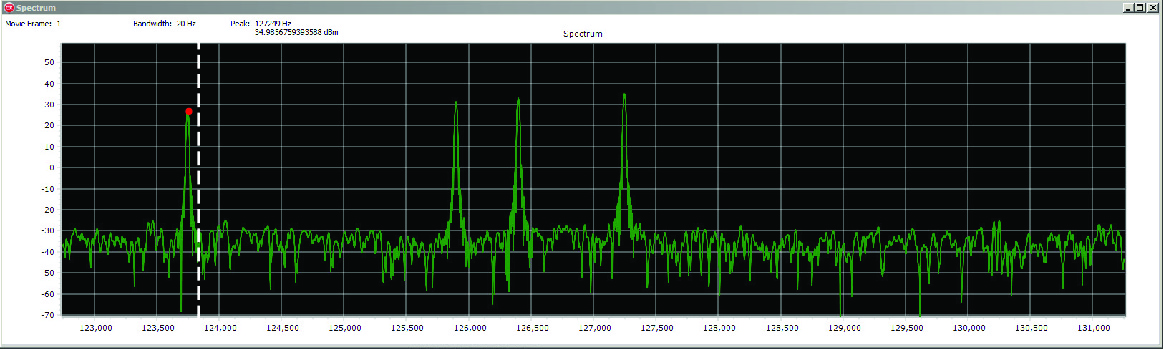

1. I’m looking to put a maker on a Series. A red dot or a dotted white line.

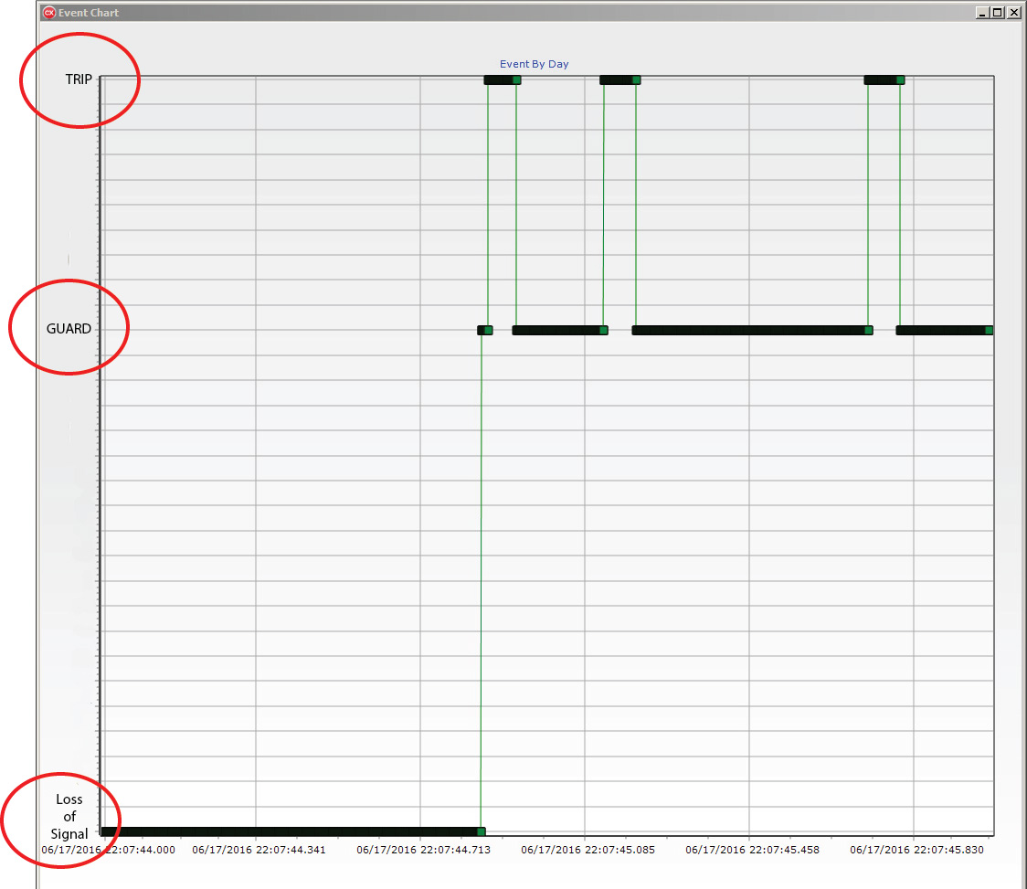

2. I want text as value for the Y side of the chart, is that possible?
I'm using C++Builder Seattle Update 1

You can use a TColorLine for this. Ie in Delphi:pcs_user wrote:I’m looking to put a maker on a Series. A red dot or a dotted white line.
with Chart1.Tools.Add(TColorLineTool) as TColorLineTool do
Pen.Color:=clWhite;
Pen.Width:=2;
Pen.Style:=psDash;
Axis:=Chart1.Axes.Bottom;
Value:=123750;
You can change the Labels Style to talValue. In Delphi:pcs_user wrote:I want text as value for the Y side of the chart, is that possible?
Chart1.Axes.Left.LabelStyle:=talValue;

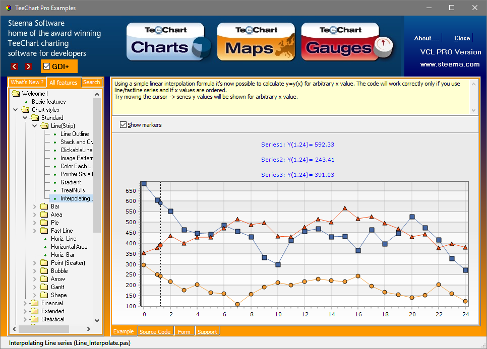

Re: Added a Maker & Text
Have you seen the demo at "All features\Welcome !\Chart styles\Standard\Line (Strip)\Interpolating Line series"?
I believe it does pretty much what you are trying to achieve.
The Features Demo is shipped with the binary version.
The binary version is the version without sources, where the packages come precompiled.
This version includes the examples and the documentation. You should find a shortcut to the "New Features Demo" in the TeeChart group in the start menu. Alternatively, you can find the Tee9New*.exe at the "Examples" folder in the TeeChart installation path.
