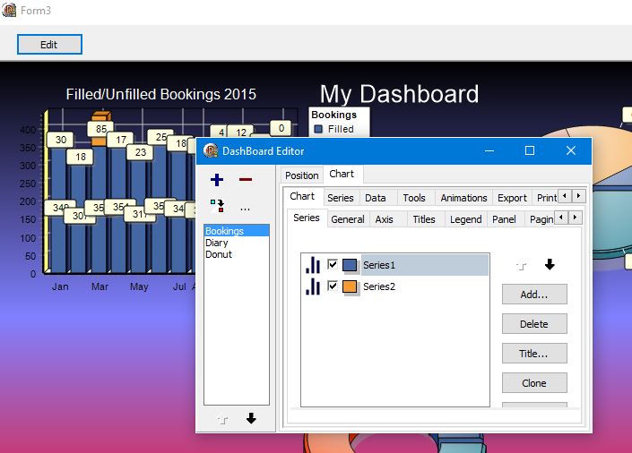

Thanks for the reply. That works for the TChart editor, but on the TDashboard when I call Dashboard1.Showeditor (from a buttonclick), it does not remember it's size and always displays quite small. Is there another way I should be invoking the editor on a TDashboard?

Actually forget about the TDashboard editor, we have decided to allow users to edit the underlying charts and save the chartsettings (stream) to the database.
